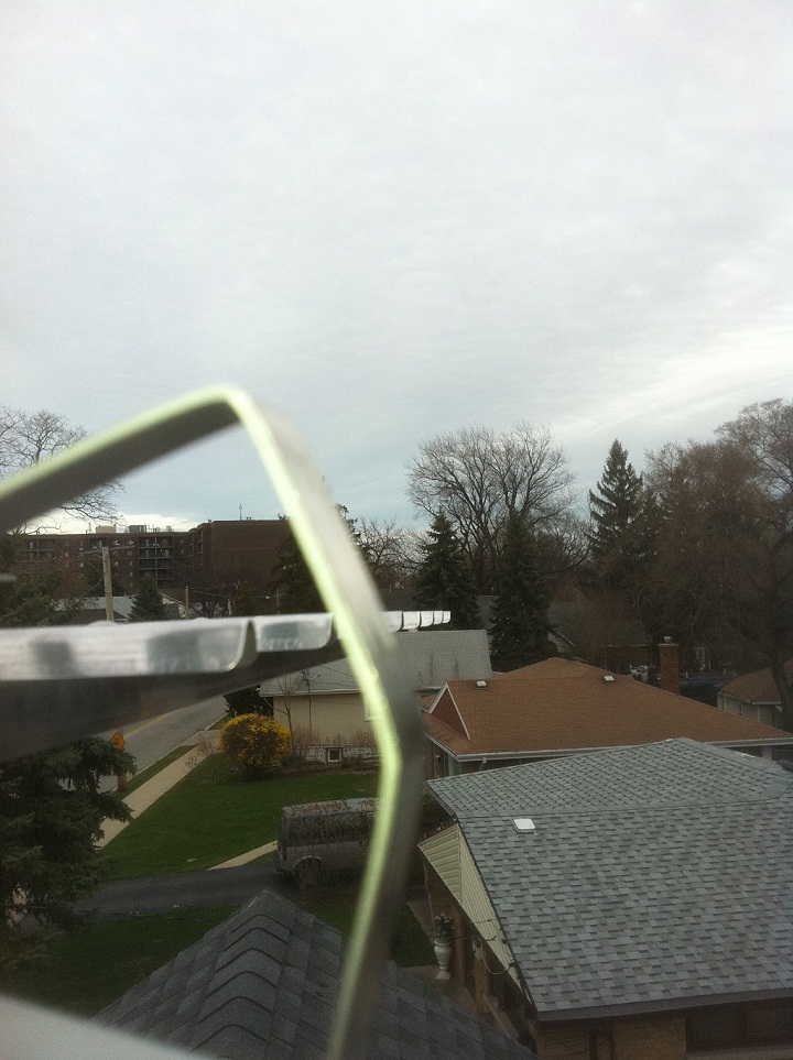

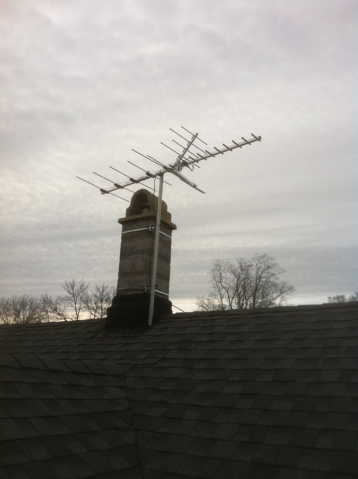

Well its up and working but I still get a lil break up on a few channels. I guess my roof isnt as high as I thought cause there are a bunch of trees in the way. Attached you can see pics of the trees. Would an amplifier help? or do I just have to live with it? Take a look at the pic.
