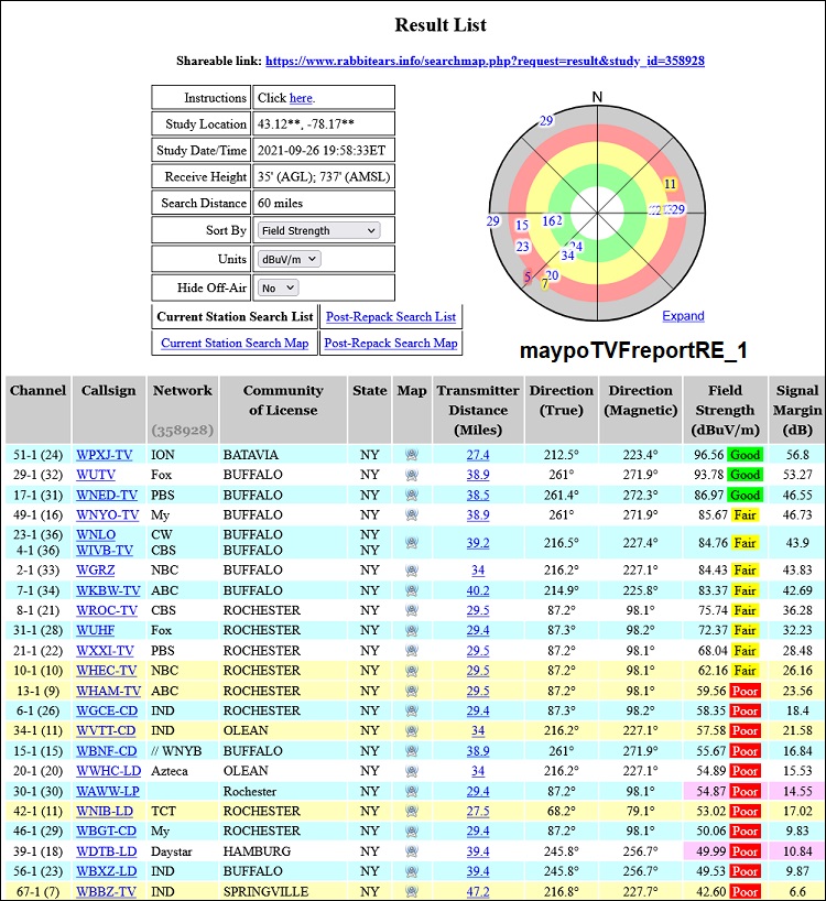

https://www.rabbitears.info/searchma...tudy_id=358928

Thank you for the signal report.
It is possible to combine the two antennas with a splitter in reverse, but it doesn't always work. When the same signals reach the combining point they can interfere with each other if they are not in phase (arrive at the same instant). You will just have to try it.

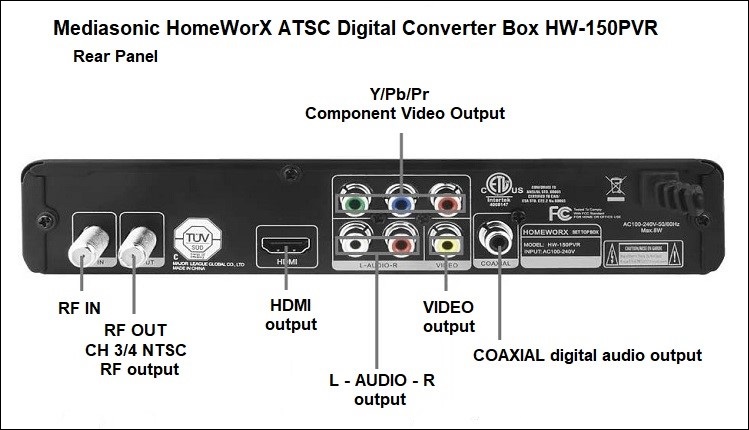

2. Connect the main antenna to the TV antenna input, and connect the other antenna to a separate tuner (like the Mediasonic HW-150 $40.00) with the output of the tuner going to the HDMI input of the TV.

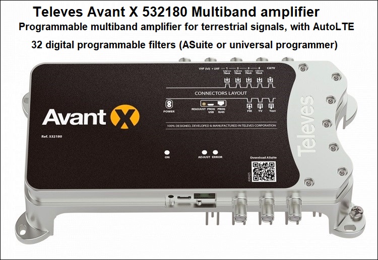

3. Use a Televes Avant X to combine all the channels from both antennas into one coax. This is the most elegant solution, but it isn't simple to set up and is expensive ($400).
