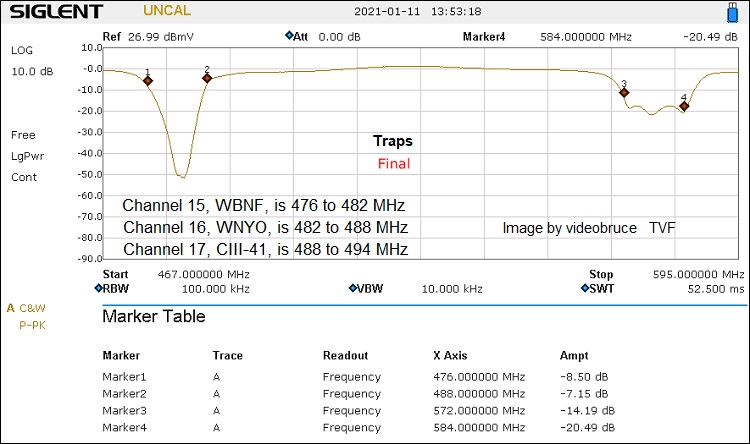

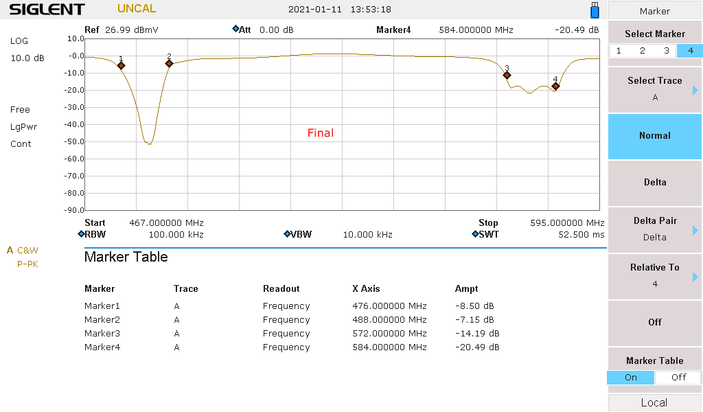

Siglent SSA 3032X
'True' north (it's easier, the house is N-S, E-W within 1 degree which makes the job very easy ).
The reference to 355 degrees is due to the offset from 330 degrees necessary being the only way I can receive the Toronto stations (RF 17-20) due to the 'swamping' effect from RF 16 even with the additional 20db attenuation from my traps. Doing so drops the offending station level over 10db making the difference.
At the present time, are you able to receive 17 that is adjacent a much stronger 16? That would seem impossible for a TV tuner to handle.
Yes it will be, especially with a crappy tuner; aka TiVo.
Is there a filter design that would work better?
I was originally going to go with Tin Lee, but due to poor communication (on their part) and cost, I went with PAR Electronics which I've done business before. I use to do business with C & E in East Syracuse NY (which were partners with Tin Lee), but they went out of business unfortunately.
See the attachment. Tuned for 15/16 and 31/32

9 kHz to 3.2 GHz, very nice
So, with traps and the adjustment of aim, 17 is possible; excellent!
It looks like the slope on the high side of 16 was adjusted to be as steep as possible to protect 17.

Possible, depending on conditions.
Yes, to protect RF 17 as much as possible which is not easy to achieve.
Correction on CHCH. That isn't available here thanks to the FCC and the CRTC. That should be WBNF, which is 40 or so miles closer.

Sorry about that. I missed the co-channel problem. Corrected image in post above.
On this forum, I make images that will show in a post no wider than 750 pixels.

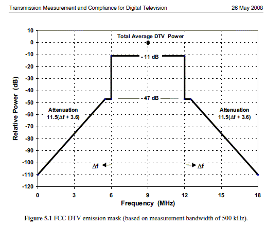

A DTV station produces splatter outside the normal ~6 MHz bandwith in both upper and lower adjacent channels.
This splatter appears as noise to a receiver that is trying to demodulate the adjacent channel signal.
If the combination of noise (environmental, thermal, other interference plus the adjacent splatter)
reduces the signal-to-noise ratio to less than about 15 dB then signal cannot be decoded.
In the above case, no amount of frequency rejection of the undesired channel can recover the desired signal.
The FCC sets limits on the splatter:
From:
ATSC Recommended Practice:
Transmission Measurement and Compliance for
Digital Television
Document A/64B, 26 May 2008
As shown in the image the splatter begins at about 36 dB below the flat portion of the DTV channel.
That adjacent splatter is caused by intermodulation distortion (IMD) in the transmitter chain.
Pretty sure many stations perform somewhat better that that shown in the graph,
but it is a tough problem for transmitter chain designers.
In addition, adjacent splatter can be generated in the TV receiving circuits.

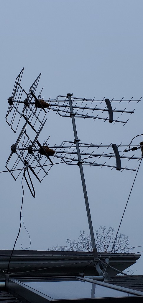

Here it is a couple of years later and I'm just now noticing this. I'm sure I've been to this site since then but apparently I missed your questions but better late than never I guess.
So I am about 39 miles north of Chicago on the Lake Michigan coastline. I'm actually below the lake Chicago Bluff which is geological history when Lake Michigan was Lake Chicago after the last ice age. This just means I'm below a ridge which is approximately on Sheridan Road so I lose about 20 ft of elevation. I also have some large oak trees directly in the path of Chicago. Not much I can do about that other than pay a tree trimmer with a high tower and gouge out a tunnel and that would do nothing about my neighbor's trees but it would improve things, but I digress. I am also 48 to 49 miles south of Milwaukee with what I would consider a fairly clear path with some trees well over 100 ft distant. I'm not so sure that those trees aren't a problem either because it's really messing with my ganging projects..
In the following pictures I have tried vertical stacking and horizontal ganging with these and other antennas. I don't know if it's the Tri-boom design or what. I may come back here and do a post just on this project if there's any interest of course.
Damn, I forgot how hard it is to upload pictures on this forum.
Since I have to go to work I'll come back but that's the first question answered. This post is not finished.
