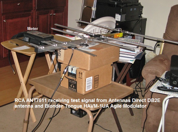

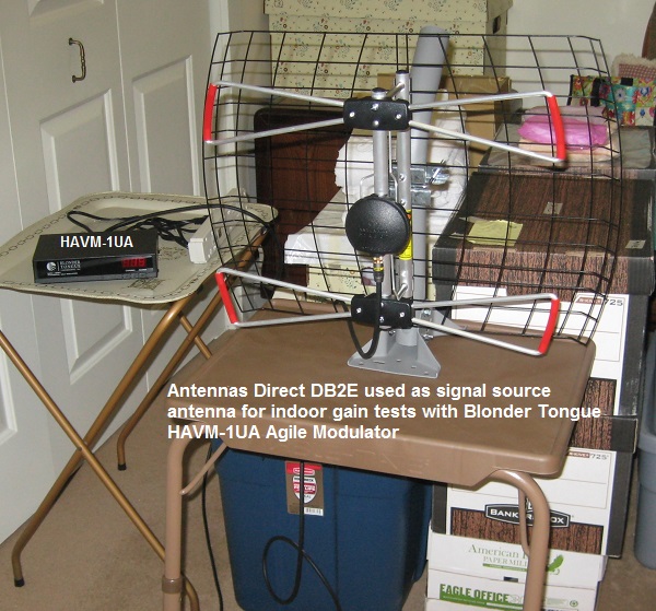

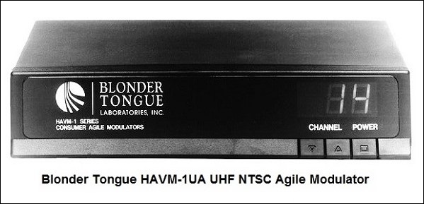

My use is very simple. I don't have a UHF signal generator, so I use the NTSC video carrier of the modulator as a constant strength test signal. All I have to do is select an output channel on the Agile Modulator and tune my signal level meter or SDR to that frequency. It isn't necessary to modulate the carrier, the video carrier exists without video or audio input.
For VHF, I use a more sophisticated (and expensive) source; I generate an ATSC 1.0 carrier with my Thor Petit Modulator.

My use is very simple. I don't have a UHF signal generator, so I use the NTSC video carrier ...exists without video or audio input.

Being a double sideband modulator, doesn't the NTSC video carrier show up twice in the spectrum?
Yes, it does; that is why you can only use every other channel when adding a channel. But, all I have to do is tune my SLM or SDR to the video carrier frequency of the channel transmitted by the modulator.

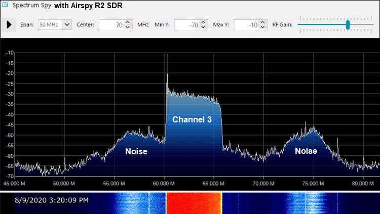

Looks like displays from three different STL-SDR units,
that is if the RTLSDR Scanner is running on one of the lower cost devices?
When comparing the SDRplay and the Airspy,
noticed the noise spectrum on the lower frequency side of Channel 3 is different for each.
Specifically, the noise is increasing near lower edge of Ch3 for the SDRplay,
for the Airspy decreases a bit near lower edge of Ch 3.
Wonder if that reoccurs, repeatable?
That is correct. The last three images were:
1. RTL-SDR.COM V3 dongle with free open-source Scanner software from GitHub
2. SDRplay RSP1A SDR with SDRuno software
3. Airspy R2 SDR with Spectrum Spy software that is included with the SDR# (SDRsharp) software download

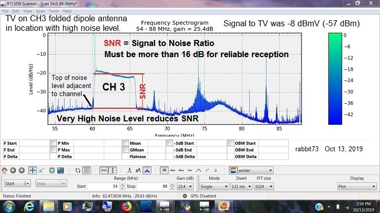

Yes; three factors account for that:
1. The noise floor is not constant on VHF, especially VHF-Low; the scans were done at different times
2. The RSP1A with the SDRuno software is limited to a useful bandwidth of about 8 MHz; each side falls off pretty fast. The Airspy R2 with the Spectrum Spy software has an extremely wide bandwidth for a scan only limited to the full bandwidth of the R2.
3. The bandwidth of the antenna

...The RSP1A with the SDRuno software is limited to a useful bandwidth of about 8 MHz; each side falls off pretty fast.
OK, understood.
