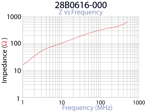

Tripleo, thank you for your detailed information. It's exactly what I need. Again as you see I have an eye for detail and I will report each and every change I make. Not just for my benefit or yours but for anybody who may try this. I know it sounds simple but for me it's like working on a new brand of car with new tools and a new scanner.
For now I plan to just try the two antenna stacking side by side. I want to do two 91XGs with the 300 ohm twin lead separate from two 30 - 2476 VHF antennas with a similar. I mean side by side and using the twin lead.
When I am done and I am satisfied I have made good progress , I hope to join them at a combining preamp. I've got a good friend making a low noise VHF UHF combo amp.
So, to stack each array antennas I believe I have ordered the correct ferrite cores. I have 10 of each number, which are Fair-Rite "Ferrite cable cores 61 Z= 280 ohm at 250 megahertz. I believe those are for UHF.
The other ones are the Fair-Rite "Ferrite cable core 43 round cable cores Z = 280 ohms at 100 megahertz". I think those are for VHF.

...So, to stack each array antennas I believe I have ordered the correct ferrite cores. I have 10 of each number, which are Fair-Rite "Ferrite cable cores 61 Z= 280 ohm at 250 megahertz. I believe those are for UHF.
As you know, UHF is 470-608 MHz. Upper VHF is 174-216 MHz.
Haven't looked at your particular ferrites. It is best to select for maximum impedance at the frequencies of interest.
For UHF, In future you might want take a look at Laird (PN 28B0616-000), it is solid and fits over regular RG6 (not quad), provides more than 500 Ohms impedance at 500 MHz. It has fairly high impedance at upper VHF as well. Maybe the Fair-Rites you have are similar, one could compare graphs.
The Laird ferrites are available at DigiKey. Think Mouser has them also. Laird also has some other sizes that are convenient, such as to fit over Connectors, etc.

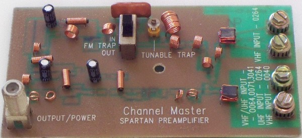

...I recently came into a NOS Channel Master Spartan 3 0064DSB with the 300 Ohm input.
I am hoping this will allow me to forgo the need for the beads and coax as the output on the Spartan is 75 Ohm.
The CM 0064DSB has a regular ferrite 300:75 Ohm balun at its input.
The core and windings are seen in the lower right of this image (near input terminals).
Could be CM used a slightly better core than used in most commercial baluns. However, the balun has loss.
Removed the core and windings, replaced with half-wave loop saw signal about 1-2 dB strength improvement.
No offense Sev, the post was quick and for a while was thinking about Bob's earlier posts.

CM-0264 Preamp
Originally Posted by Sev View Post
As anybody ever added the missing components on that board to switch it to a 0264?
Seems feasible.
Main item is additional balun.
PCB traces are already there. Need to cut an etch connecting UHF & VHF, etc. Probably have to solder in a small jumper.
Maybe touch up tuning on input coils.
...Would have have a picture of the 0264 board? I have yet to come across one.
Yes, below, CM-0264 Circuit components:

The graphs of ferrite impedance look OK for your application.
Man, they are so very careful about the packaging. I guess they are very brittle.
They are a form of ceramic, if they bang against each other they crack and separate.
..Are you thinking I only need two Ferrite cores or, the more the merrier?
Merry is a good state.
At least one at the junction and at least one at the 1/4 wave length, 5.5" down?
Looks like your UHF Fair-Rite's have somewhat more than about 400 Ohms impedance at 500 MHz. If you use four of them, that makes at least 1600 Ohms (from ferrite) to resist signal passage down the coax shield. Splitting locations, 2 at junction and two at 1/4 wave would likely increase the effective impedance to well above 1600 Ohms.
Four of them together at 1.126 inches length each would cover about 4.5 inches. Splitting for quarter wave leaves only a small space between.
The signal can divide some portion to pass through the interior of the coax at 75 Ohms impedance, some to pass through 1600+ Ohms (plus the inherent impedance down a coax shield outer conductor).
The point is, the higher the impedance, the less signal passes on the outer shield. Signal on the outside of the shield is for practical purposes 'lost'.
There are practical limits, cost, weight, difficulty handling and securing a ferrite laden cable.
In some cases, two or three is about all a connection at a junction can handle.
Diminishing returns, revisited.
