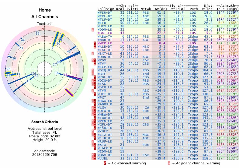

Thank you for the signal report. What antenna do you have on the roof now and what channels do you get with it?
TVFool is using a defective database to generate reports, so there are some errors in your report:

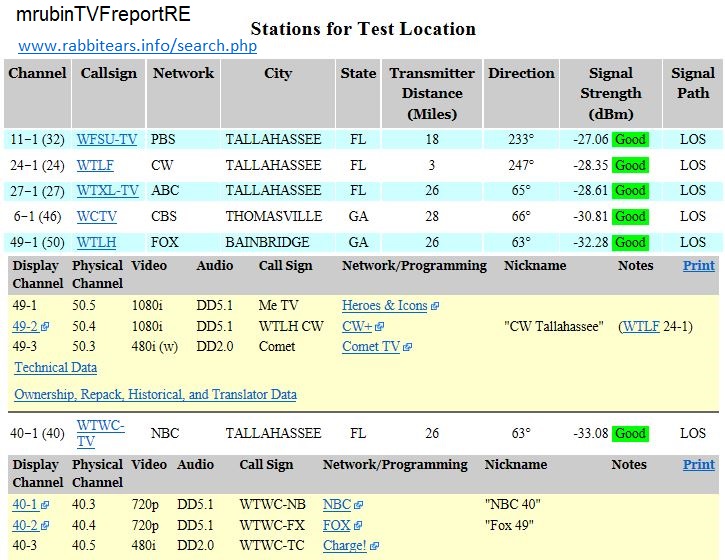

A report from rabbtears.info is more accurate:
Most of what you want is coming from 63 to 65 degrees, except for PBS.

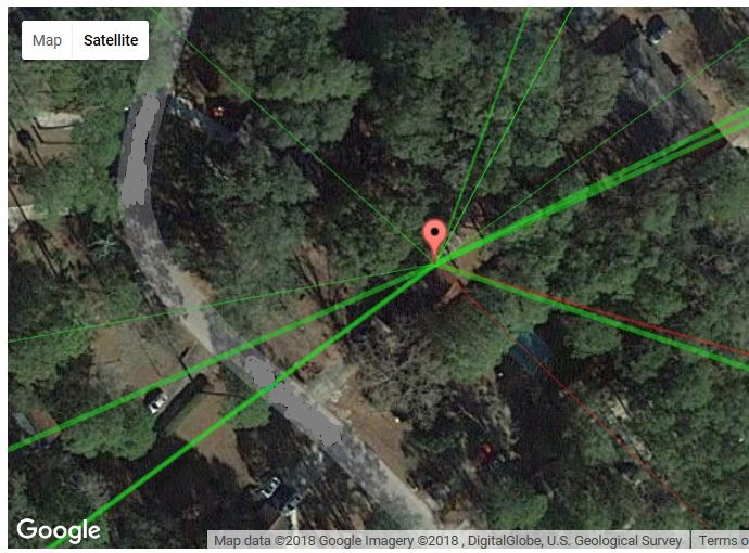

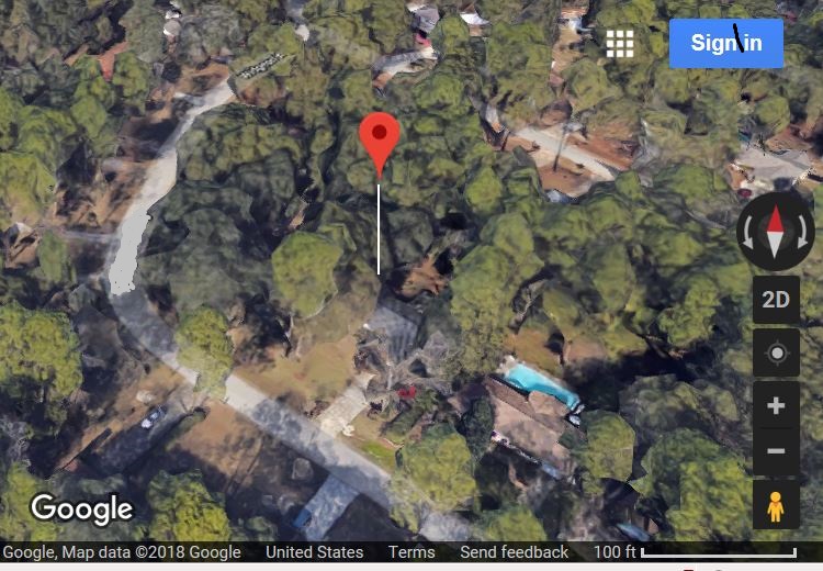

An Antennas Direct DB4e UHF antenna might work, but I'm worried about the trees; they block TV signals. See attachments.
Because of UHF Repack by the FCC, some of your channels are moving.
WCTV will be moving from real (physical or RF) channel 46 to 20. You will need to rescan:
https://www.rabbitears.info/market.p...&callsign=WCTV
WTLH from 50 to 19:
https://www.rabbitears.info/market.p...&callsign=WTLH
WTWC from 40 to 22:
https://www.rabbitears.info/market.p...&callsign=WTWC

A large beautiful oak tree in my backyard of course placed in the direction of the towers.
My reaction is that you will have to either get the antenna from behind the tree or remove the tree from in front of the antenna to improve your reception.
scroll down to Trees and UHF
