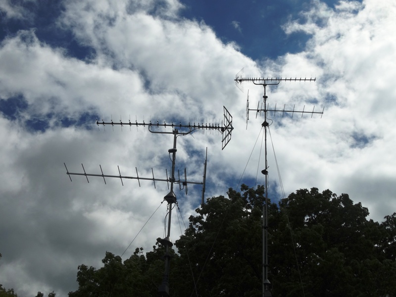

Here, you can imagine what it the array will look like: HDB91X and 30-2476:
The 30-2476 may be more wind worthy than the DB4e and much more wind worthy than the RCA 3036XR, both are wind catchers.
Yeah that's about how I planned to mount I was surprised the 30-2476 is only 5" shy of the HDB91X, any reason more forward mounting of the 30-2476? I have mine set to be more centered with the reflectors parallel, planning on about 3' spacing.
The 30-2476 may be more wind worthy than the DB4e and much more wind worthy than the RCA 3036XR, but both are wind catchers.
Yeah, its a bit of a sail but both are light & my top mast is less than 10'.

The only reason I mounted it forward is because the instructions show the mount there. And that's how it ended up on the mast. I know I thought the same thing later when I looked at it. And the funny thing is the ad picture of it shows the clamp between another set of elements than the instructions show.
Mine should probably be mounted even. I don't know if there's a rule on that or not. It may not matter.

Also, I am assuming you are using the "real" channels numbers, not the virtual number, it appears to be the case.
