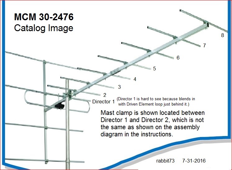

Hi Guys,
I just got a 30-2476 the other day.
The position of the mounting clamp does not seem right to me.
Shouldn't the clamp be mounted closer to the middle of the antenna?
If so, would it affect the signal on some channels?
Or maybe add a diagonal brace from the mast to the antenna ?
Any thoughts?

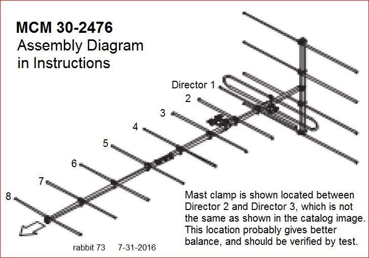

The clamp should be mounted at the center of gravity.

Between the 1st and 2nd director as shown in the 3rd photo in post #7.
Is that where it is located on your antenna?
A diagonal brace should not be needed if the assembly was done correctly.
I think you are right.
Good catch!
http://www.mcmelectronics.com/conten...ls/30-2476.pdf
The 30-2476 has the clamp location in the catalog image that is not the same as the clamp location in the instructions diagram.
The optimum point is at the center of gravity which has the same WEIGHT on each side, not the same LENGTH, like a seesaw.
When the clamp is at the center of gravity, there is less chance of the angle adjustment changing, because the rotational torque is equal in both directions.
https://en.wikipedia.org/wiki/Seesaw
Since the clamp fastens around the boom instead of through the boom, it should be possible to move it forward or backward to the balance point.

Hi Newmguy,
As Rabbit told you, the center of gravity is the best mounting point for balance of weight.
In the case of the 30-2476, the reflector is fairly large an adds weight to the rear of the antenna, forcing the designers to move the clamp rearward to obtain balance.
Let us know how your 30-2476 works.
Thanks, Bob
Good catch!
Good catch, both of you!
I have to say, that the images do differ in the location of the clamp.
Mine seemed pretty solid, so I didn't question it.

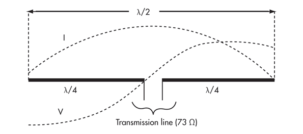

Rabbit, how much influence can the mast have on reception?

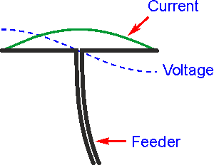

Very little; not enough to worry about. The antenna has horizontal polarization to match the transmitted signal, but the mast is vertical. Also, the mast is located near the center of the elements where the signal voltage is at a minimum which reduces the influence of the mast.
The ends of the elements, where the signal voltage (E) is highest, are more sensitive to touch and nearby objects. The current (I) is highest at the center.
https://en.wikipedia.org/wiki/Dipole_antenna
File Type: gif dipole-half-wave-current-voltage-waveforms.gif (1.8 KB, 1515 views)
