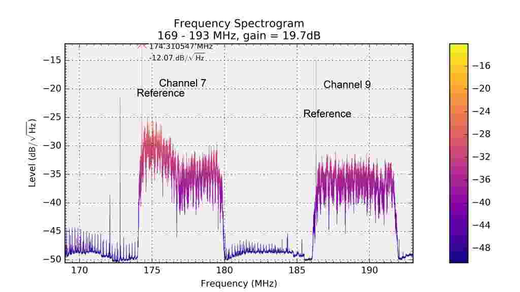

At one point during the day CH7 had a 100% Symbol Quality at the same time, adjacent CH9 was zero. I did a spectral scan.
Thanks for the new scan. They both LOOK pretty healthy. CH 9 is almost as strong as 7, but 9 has a tilt in the channel level and its pilot carrier isn't as well defined.
The only differences I can find are 9 is running a little less power, its antenna is a little lower, and it is on a higher frequency which will change the scattering of its signal from the rough terrain.
But, the tuner makes the final decision on signal quality (SNR & errors), and it says NO GO for 9.

In theory, it should be possible to optimize the antenna aim for channel 9 by monitoring its pilot carrier, which is at 186.31 MHz.
It is not possible to receive digital TV audio with a scanner or AM/FM receiver.
Before the transition from analog to digital TV in 2009, audio from analog TV stations could be received in wideband FM (WFM) mode. Each audio channel used 100 kHz bandwidth.
The 8-VSB modulation used in ATSC (DTV) has a pilot carrier that serves as a reference frequency for DTV receivers and can be heard on an AM or FM (narrow band) receiver. The pilot carrier is approximately 310 kHz (.31 MHz) above the lower band edge. The exact frequency used may vary because the transmitted signal may be offset slightly to reduce interference.
In actual practice, it's quite possible to have a perfect pilot bu have another part of the 5.38 MHz bandwidth completely grunged out due to multipath condition. That would show up as a deep notch, for example, somewhere within that bandwidth.
That is correct, but his scan doesn't have a notch, so I think it is worth a try. OP acat is at the point now where he is willing and able to try any experiment to receive channel 9, witness the fact that he climbed the RTL-SDR learning curve with great success. He is even willing to try an Anti-Ghosting Antenna.
