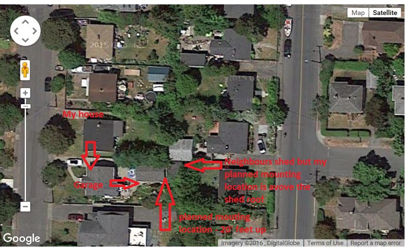

Old 5-Jan-2016, 5:09 PM   #9
Shaunms
Join Date: Dec 2015
Location: Victoria, bc
Posts: 6
thanks for the reply. I do have a few trees around! I have attached a copy of your pic with some details that may help. When standing on a ladder next to my planned location I get a clear line of sight above roof lines etc of neighbors sheds and roofs. At work right now but will try to snap a pic from the ladder pointing towards channel 22

Tower Guy
Location: Delmar, NY
Posts: 1,236
Would a pair of 43 XG antennas stacked 42 inches apart hang over your neighbors?
Old 5-Jan-2016, 7:23 PM   #11
Shaunms
Join Date: Dec 2015
Posts: 6
they would just cross over. The advantage I have is the neighbor in question has a shed that would block their view of the antenna's. So if it hangs over a few inches I am not worried so much. with the 91xg's they would hang over a couple feet.

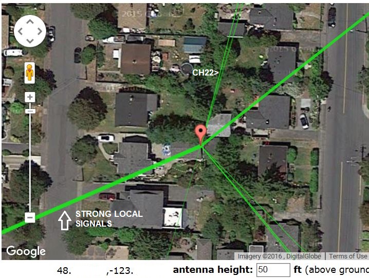

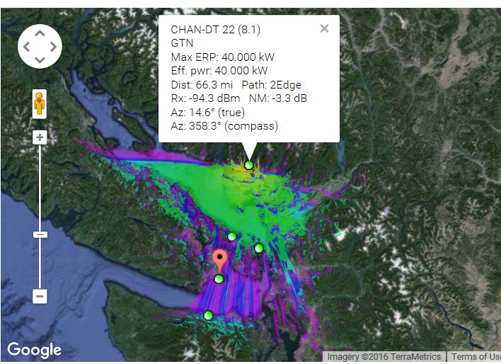

Thanks for the image with the notes. This is what I wanted to do:
I deleted the numbers after the decimal point in the coordinates for your protection and increased the height to make the CH22 green line easier to see.
You ARE on the CH22 fringe, but a -3.9 NM can be compensated for by antenna gain. The biggest problem is interference from strong local signals. The FB/FR ratios of the antenna can attenuate the strong locals to some extent, but there will still be reflections from the strong locals off objects in front of the CH22 antenna.
The terrain causes a lot of interference to the signal.
http://www.tvfool.com/?option=com_wr...ALLTV%26n%3d12
