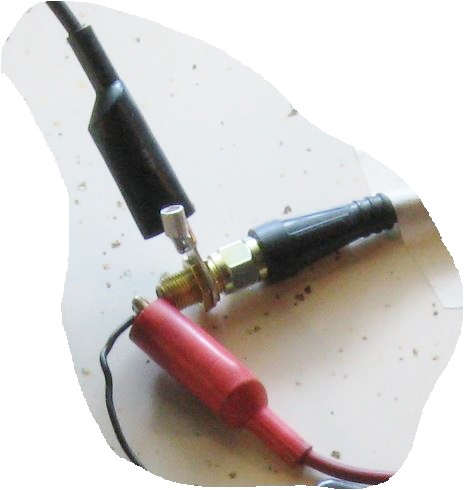

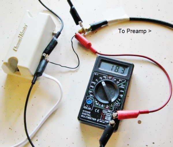

Simply disconnect the coax lead from the amp and measure between the shield and the center conductor of the coax. Anything between 12 and 18 volts is expected.

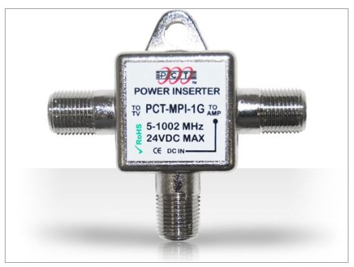

That is a little tricky to do with the end of the coax coming up from the power inserter that connects to the preamp. You have to connect one voltmeter probe to the coax shield and touch the other probe to the center conductor without shorting it to the shield. I sometimes insert the cable connector into an F81 adapter and insert a short length of 18 gauge bare copper wire into the other end of the F81. The 18 gauge wire is the same size as the center conductor of the RG6 coax. The attachments show me checking the voltage at the lower end of the coax when the preamp (old model 7777) is powered.
