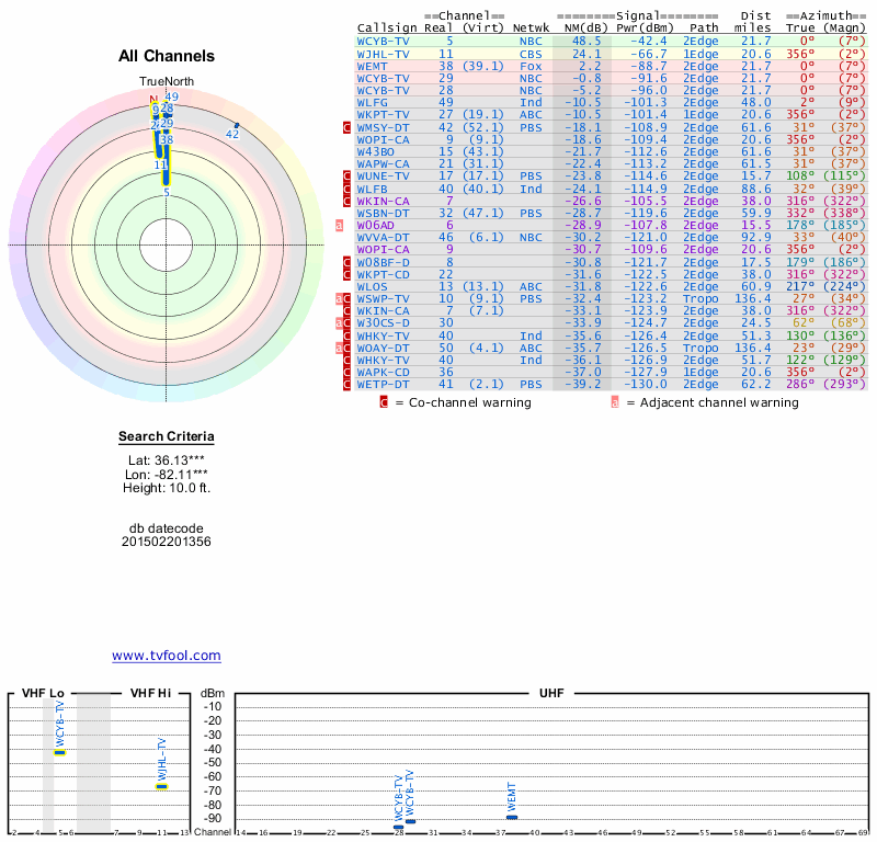

I am new to this forum and also to ota antennas. I need a little advice on the best antenna for my situation. I would like to pick up as many channels as possible as economically as possible. i'm just trying to find out if I can get enough channels to get rid of my satellite provider. my tvfool report is included and I will be waiting for your suggestions. thanks for your time.

1. Please post the actual link to the TV Fool Report. It is clickable provides information in addition to what is in your graphic.

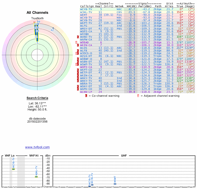

2. Ten feet is not very high for an antenna. And the signal strength is very weak at your location. Please re-do your TV Fool Report using the following directions: http://forum.tvfool.com/showthread.php?t=14508 -- Make new reports at the height you'd like to put your antenna (roof top level) and than at 35 feet and 50 feet (you may not go that high but the details provided by the report are useful).

I hope these are the links you need as I am not too familiar with the site yet and my computer is old and takes a long time to load these but if not I will try something else. if I put the antenna in the gable on my house it would be around 25 ft. high. I only put 10 ft. on the other one as it seemed as if the higher I went the lower the power got on my reports. of course I could be reading them wrong. anyway, thanks for replying.

There are HTML links embedded in your TV Fool reports. Each call sign can be clicked on to open a path profile for that signal path. When you post a PNG image you prevent us from seeing that valuable information. It's best to simply cut and paste the HTML link for your report(s) as a part of your post.

The path profiles make clear that you face significant terrain obstructions. If I was in your situation, I'd be looking for a vendor with a liberal return policy. If I was confident I wouldn't be stuck with an antenna that has little or no quality signal available, I'd try a Winegard HD7084P. Avoid aiming through trees if at all possible.
