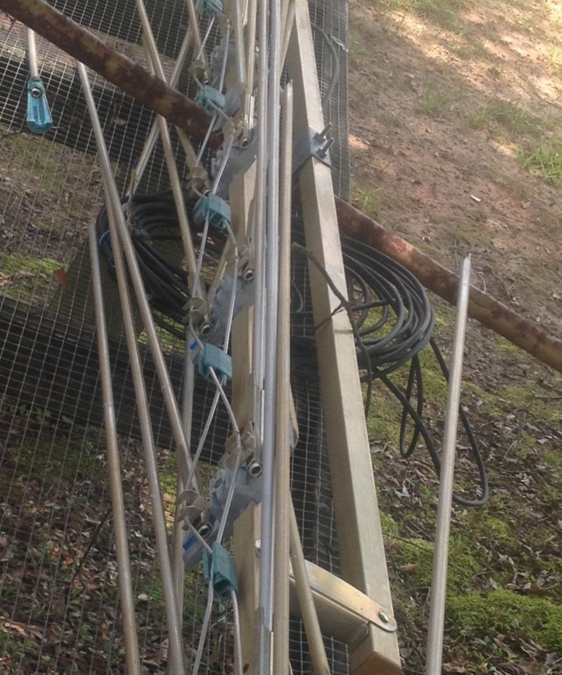

I found the antenna below at a house of our farm property, left behind by tenants a few years ago. I don't know anything about antenna, but I did drop satellite TV a few month ago and wouldn't mind picking up local channels.
My question is: Can I mount this antenna in the attic and, based on the report linked below, pick up channels WBIQ and above?
Any and all help and advice would be greatly appreciated.

It's hard to tell if the antenna has any UHF capability, the photo does not show the entire antenna. What I see is a worn & broken VHF log periodic dipole array (LPDA) which may or may not have a UHF section on the front end of it. If present, the UHF section would be a group of short elements and there may or may not be a corner reflector assembly at the rear of the UHF section.
You need an antenna that supports both UHF and VHF reception.
The signal levels shown on your report for WBIQ and the six just above it on the list will need a high gain antenna... and it needs to be outside, clear of obstructions. Reliable reception from inside an attic is not likely.
I would opt for a Winegard HD7084.
