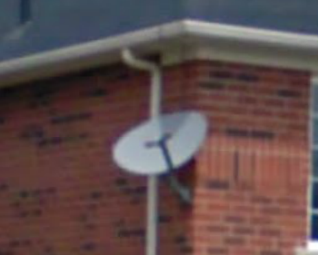

Hi all,
As many new folks here I'm completely lost on what antenna to choose as the selection is quite wide
I was thinking about an outdoor antenna as I currently have a satellite dish mounted on a side of a house (left by a previous owner) and it's already wired to the living room. But I'm open for any advice.
I'd like to get as many HD channels as I can without using a rotor. And I'm going to connect it to just one TV for now.

If you want the Canadian stations at 183 degrees and some of the US stations at 166 degrees magnetic, you need to mount a Winegard HD7084P antenna and a Channel Master 7778 amplifier above the roof. Your satellite pole will not work with this large all channel antenna.
Use any mount that will support the antenna above your roof aim the antenna to 166 degrees magnetic. Choose a spot that is clear of large trees or any other obstructions. You can shop for mounts where ever you purchase the antenna.
If you need simple and only want the Canadian channels, you can use the satellite mount, (provided it is located where there is a South view) to mount an RCA ANT751 antenna with no amplifier.

Mounting a Tv antenna on the side of the house will not provide many Tv channels.
This is a Simple reception situation.
Install a Winegard HD7084P antenna with a Antennas Direct CPA-19 preamp Above the roof so that the antenna clears the roof aimed at about 183 degree magnetic compass.

Thanks a lot for all the replies, guys! I'm leaning towards the ANT751 as it's much easier to install and cheaper too.
