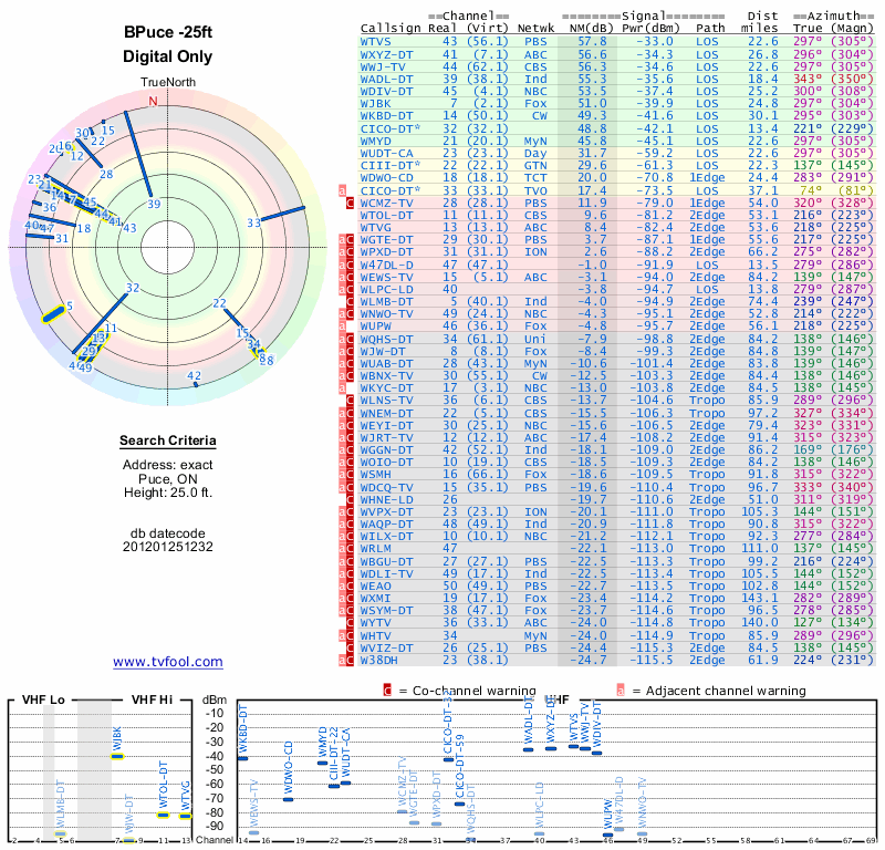

Hi... I just dumped cable and now looking for antenna advice.... Wondering what my best antenna / rotor option is. I also thought about using multiple antennas pointed in different directions but upon doing some reading this seems trouble prone...I have 3 relatively new TV's to feed a signal to.. Used to have a gable end mounted CM Quantum w/pre-amp & rotor years ago until the weather got to it. Would consider new gable mounting a new set-up or perhaps even do a tower if it is worth it? My old antenna was mounted about 25 ft high so i have included info for my location assuming 25 ft height here:
http://www.tvfool.com/?option=com_wr...0b86ab2fa66e62
(Also attached the info as well)
Any advice would be much appreciated... thanks... Bernie.

With the number of strong signals over a wide range of angles, what you need is NOT antenna gain, but wide range of sensitivity. Fortunately, these go hand in hand.
Although you do not need the Lo-VHF capability of these antennas, the inexpensive AntennaCraft AC9 or Winegard HD7000R should do well, and you should not need an amplifier. Start with an aim of 290 degrees and tweak to "fit". If you need a boost to feed your TV's then get a distribution amp.

Your location has many strong signal strength tv stations all around the compass. Install a Channel Master Cm 3000A antenna above the roof in such a manner that the the antenna has a good unobstructed view in all directions.

Re. Question #6) The neighbors trees stand out as the primary concern. If you can't get around or over them, a larger, more directional antenna may be needed for reliable reception. In some cases, the best you can do is go low to avoid the foliage.
If aiming toward Detroit involves the large trees, I'll express serious doubts about using an omnidirectional such as the CM3000 and advocate for a Winegard HD7694P.

I agree , the big thick dense trees will be a problem for reception with the CM3000A. So install the HD7694P. Start with a aim point with HD7694P antenna at about 290 degree magnetic compass. Here is how to aim antennas , http://www.kyes.com/antenna/pointing/pointing.html. THe HD7694P antenna is fairly directional in the forward direction , and will receive at other angles to the antenna and will receive some through the back of the antenna. This is the way that I look up to see what the programing is on tv stations/channels ( this will help in identifying what tv stations are being received and in what direction ) . In the Google search box I type in , as an example , wxyz tv , the two main source of information are wikipedia and rabbitears.info that will show up in the list of web sites as a result of typing , wxyz tv , in the Google search box. Some variations of the search would be , wxyz 41 or wxyz-dt 41.
