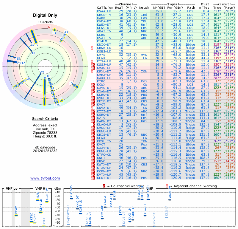

Moving to a new house, and planning to lose the cable. HOA will require a hidden antenna, so planning to install an antenna in the attic.
EDIT: 2 story house, prewired for cable
EDIT 2: I really want to avoid the need for any kind of rotator device due to attic install and W.A.F.
http://www.tvfool.com/modeling/tmp/0...getdigital.php
only looking for the following channels, my question is what would I really need (attic antenna/ amps/ etc), as not all stations are at similar azimuths....
channels of insterst w/ info from here and antennaweb:
TVFool details:
NM(db) Pwr(dBm)
KABB 30 (29.1) 17.4 miles at 164° (159° Mag) 63.7 27.2- LOS
KENS-DT 39 (5.1) 18.9 miles at 164° (159° Mag) 62.4 28.5- LOS
WOAI-TV 48 (4.1) 18.9 miles at 164° (159° Mag) 61.2 29.6- LOS
KSAT-TV 12 19 miles at 163° (158° Mag) 56.4 34.5- LOS
KMYS 32 (35.1) 33.1 miles at 279° (274° Mag) 22.8 68.0- 2Edge
KCWX 5 (2.1) 44.4 miles at 339° (335° Mag) 20.4 70.5- 1Edge
KPXL-DT 26 (26.1) 42.5 miles at 278° (273° Mag) 11.3 79.6- 1Edge
Antennaweb details:
KABB-DT 29.1 FOX RF Channel: 30 18 miles at 163° UHF Yellow
KENS-DT 5.1 CBS RF Channel: 39 19 miles at 163° UHF Yellow
KSAT-DT 12.1 ABC RF Channel: 12 20 miles at 162° VHF Yellow
WOAI-DT 4.1 NBC RF Channel: 48 19 miles at 163° UHF Yellow
KMYS-DT 35.1 CW RF Channel: 32 32 miles at 279° UHF Green
KPXL-DT 26.1 ION RF Channel: 26 42 miles at 278° UHF Red
KCWX-DT 2.1 MNT RF Channel: 5 44 miles at 340° VHF Violet

Redo your TV Fool Radar plot with your exact address. Attaching a picture of the plot is of little use. Do what everyone else is required to do. Post a link to your TV Fool Radar plot.

Looks like your location is surrounded by airports. This is not good. Reflected tv transmissions off of moving planes causes a lot of multipath - reflected signals , moving reflected signals , not good. I will return with some antenna recommendations.

http://www.tvfool.com/?option=com_wr...0b86e982908104
reposted link... I guess I posted just the image vice the actual page... sorry...

Reflected signal are weaker of signal strength and out of time with the main signal. Broadcast Tv digital tuners have circuits that reject weaker out of phase/time signals , however the tuner can be overwhelmed. With your situation , attics can sometimes help with reception. The roof material will reduce the signal strength of the main signal and the reflected signals. Reducing the signal strength of the reflected signals is important so the tuner not overwhelmed. I recommend try a Winegard HD7000R antenna in the attic aimed at about 305 degree magnetic compass as a starting aim point. Here is how to aim antennas , http://www.kyes.com/antenna/pointing/pointing.html. Here are places to buy antennas and etc. , http://www.winegarddirect.com , http://www.solidsignal.com , http://www.amazon.com.
