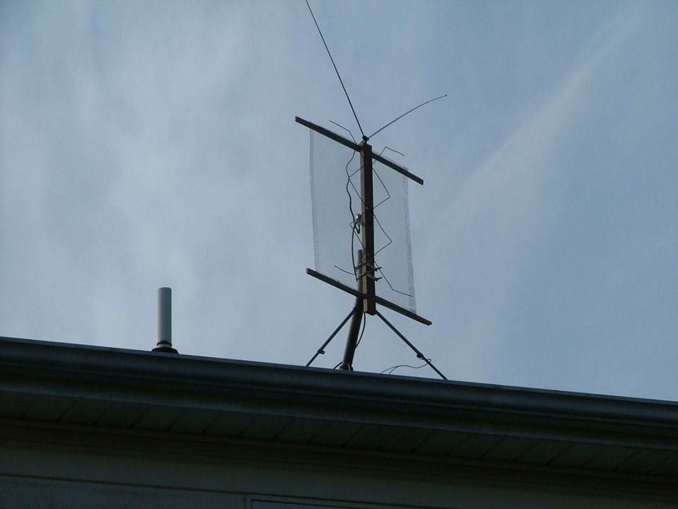

I made a temporary antenna and just have a quad sheilded cable running from it down the roof and into a window in my room with the big screen TV, right now. No pre-amp.
I u-bolted it to the j-mount from an old DirTV dish that I removed. If you soom in, you can see the old DirTV dish sitting on the north end of the roof if you use these co-ordinates:39.714037,-75.662016 It sits just above my second story peak on the N end of the roof but, the line-of-site isn't the best, pointing NE towards the Philly stations because of a line of 45-50 foot spruce tree that are two properties N of me. The trees extend to the E and end at the left edge of my line-of-site, NE of the current mast position on my roof.
I have to take a picture of my current antenna and post it but, I used #8 solid bare copper wire, purchased at H.D. and and fashioned the elements in a Hooverman antenna configuration something like this
http://www.digitalhome.ca/ota/superantenna/index.htm
but instead of the horizontal reflector elements, I just used a 1/4" screen which I know won't work in snowy weather. It was an experiment and I get 3-1, 6-1 (-2&-3), 10-1(-2,-3). 12-1,-2,-3 and 17-1, and 23-1 are all too weak to lock. I wonder if a pre-amp will help. I'm going get back up there and make a minor adjustment, today. 29-1 (FOX) is also too weak to lock. I do get 57-1 and 61-1 as well as 48-1,-2,-3, and -4.

I failed to mention in previous posts that my home-made antenna includes so rabbit ears. Perhaps that is why I am getting the VHF channel six so well.
I attached a picture of the antenna that I made, taken from the ground level. Again, this is TEMPORARY.
