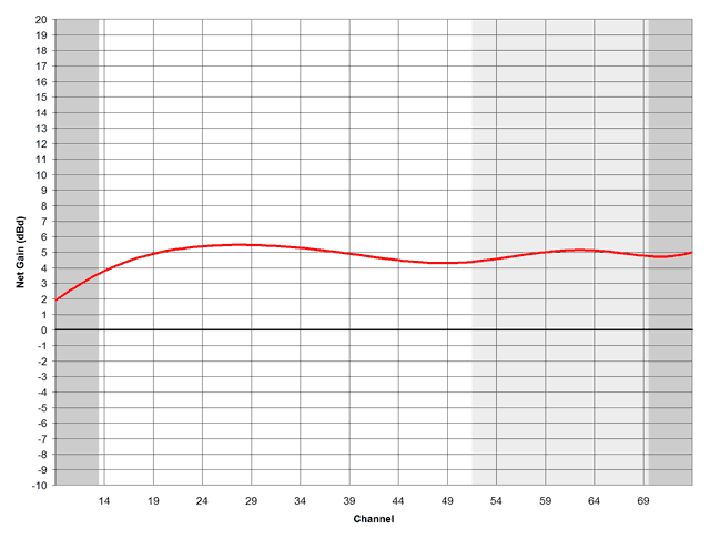

Silver Sensor
Description
This small log periodic antenna was first introduced by a U.K. based company called Antiference. It was later licensed for sale in the U.S. by Zenith, and now it is being licensed by Philips. The influence of this popular antenna design can also be seen in copy-cat products like the Terk HDTVi (which adds rabbit ears to mix).
Typical Application
- Indoors, set-top, suitable for strong to medium signals with only mild multi-path.
Size
- Approximately 13.5" wide, 13" long, and 9.5" tall
Operating Frequencies
- UHF only
- Copy-cat products that include rabbit ears may also provide some VHF capability. See the post on rabbit ears to get a feel for the potential VHF performance.
Gain
- This antenna gets between 3 and 6 dBd at different points within the UHF band.

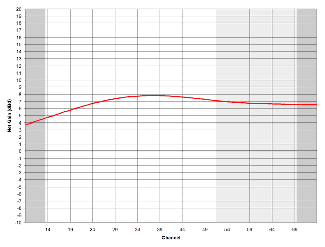

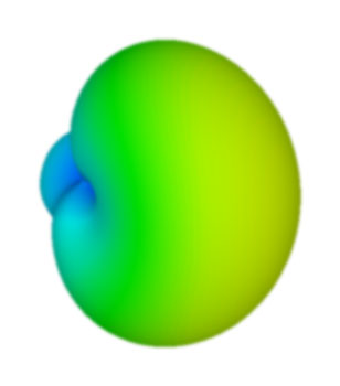

2 Bay Bowtie
Description
Several manufacturers make 2 bay bowtie antennas because of its simple design, reasonable gain, and compact size. Some of the more common variants include the Channel Master 4220 and Antennas Direct DB2.
Typical Application
- Outdoors, patio or roof-top, suitable for strong to medium signals with only mild multi-path.
- Although these are intended for outdoor use, they are also small enough to be considered for indoor use as long as you can figure out a way to mount it and don't mind the size/aesthetics/weight (it's a bit bulkier than your standard set-top antenna).
Size
- Approximately 20" wide, 18" tall, and 7" thick
- UHF only
Gain
- This antenna gets between 4 and 8 dBd at different points within the UHF band.
Aiming
- This antenna has its maximum gain out its front. The face with the bowties should be aimed toward the transmitters. The horizontal beam width is approximately +/-30 degrees from side to side (60 degrees total width), in case you need to fetch channels spread apart by several degrees.

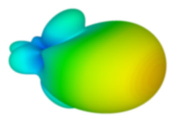

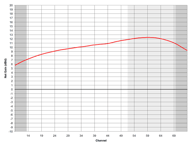

4 Bay Bowtie
Description
Several manufacturers make 4 bay bowtie antennas because of its simple design and good gain. Some of the more common variants include the Channel Master 4221, Antennas Direct DB4, and Winegard 4400. This design is also the basis of a very popular DIY "coat hanger" antenna seen on the internet.
Typical Application
- Outdoors, roof-top, suitable for medium to weak signals with moderate multi-path.
Size
- Approximately 20" wide, 35" tall, and 7" thick
- UHF only
Gain
- This antenna gets between 6 and 13 dBd at different points within the UHF band.
Aiming
- This antenna pattern is very similar to the pattern of a 2 bay bowtie antenna except that the main lobe has been "squashed" in the vertical direction. The horizontal beam width remains about the same, but the vertical beam width is smaller.
