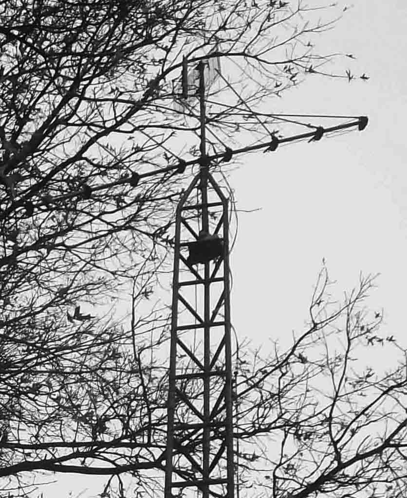

Tower-Antenna Pics Attached
The tree has been trimmed, so it wont be an issue (hopefully), the tree is south, and the antenna points north.
The VHF antenna you see is gone, makes me wish I didnt get rid of it, I thought ALL channels were broadcast in UHF. Will the Cleveland stations still broadcast in VHF go to UHF soon?

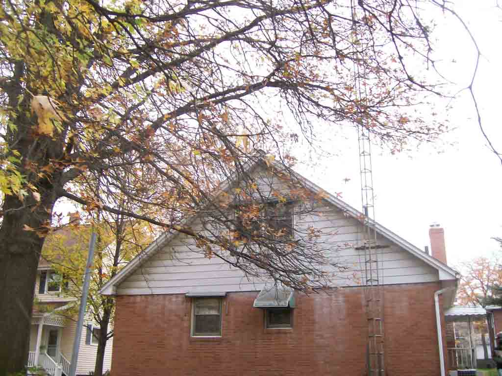

There's a tutorial somewhere that explains the Noise Margin figure. Applying that to your situation, the MANT has very little, if any gain at UHF, and probably -6 to -10dB gain at VHF. These figures add to your NM. The internal amplifier probably has a 5dB noise figure that subtracts from NM. The 18dB serves only to overcome cable loss in this case. Combining these values to the NM of VHF stations WOIO (14dB) and WJW (20dB), and you get near 0dB and 6dB net noise margins. Protecting against random fades usually requires having a 10dB or higher NM, you can see why you're getting the results you have.
Here's a radical thought: since you have plenty of UHF signal, the MANT provides enough net MN to work reliably. Since the antenna is small, with little directivity, it is picking up Youngstown and Cleveland UHF acceptably, save for WYTV. Why not build a simple bow-tie antenna scaled for VHF, mount it on the tower towards Cleveland, and join it with the MANT with a USVJ? You'll have only $15 or so invested in such a solution.

Originally Posted by rwilson1206 View Post
Are two antennas really necessary?
I would like the option of something side mounted to be a possibility, just it case I cant install it at the top.
I have a phillips 18db signal amplifier now, if I had to throw that in the setup somewhere, and another 18db inline that the phillips antenna came with, although I dont know if its esp for that antenna, I think it is.
Two antennas or a rotor, your choice.
The 4221 can be side mounted, but it won't pick up WJW or WOIO. The only VHF antenna designed to be side mounted is the Antennas Direct C5. If you opt for the C5, you'll need three antennas.
Amplifiers are fickle. A good amp can help pick up a weak station, but two amplifiers or the wrong selection, and you loose the advantage.
