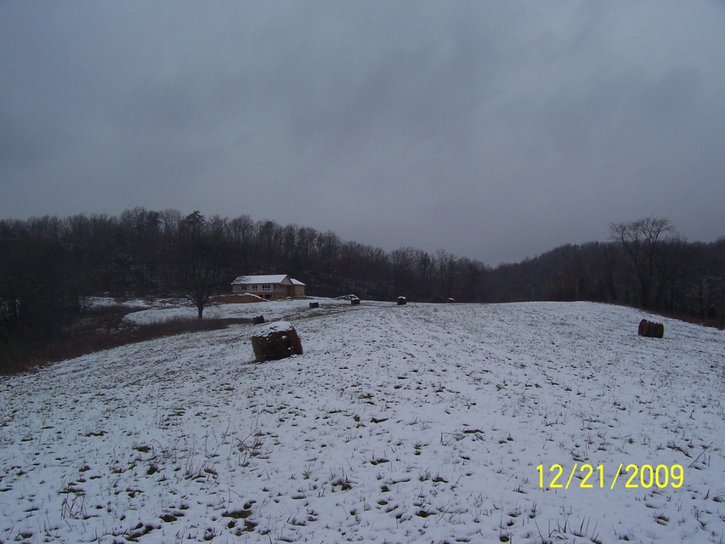

Here are a few pics of the hill behind our house:

crgshhn, In the first photo of your house, what direction does your front door face?
Well, you can't actually see the "front" of our house but here is the photo with my attempt at adding directional arrows. Does this help at all?
Thanks!!
