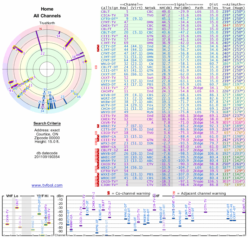

Here is the signal strength report. My antenna is 15 feet above ground. I was not receiving FOX at all last nigth, had a signal between 3 and 17 percent

Originally Posted by 49Leafs View Post
Attachment 231
Here is the signal strength report. ...
Please redo your radar plot with your exact address. Post a link to the TV Fool page rather than a picture of the plot. Pictures are not interactive.

As others have done , Please Do Not take a picture of the radar plot , it is dead and we can not use it. http://forum.tvfool.com/showthread.php?t=2167

The FOX station transmits on ch. 14, and your antenna is far less sensitive at the low end of the UHF band than the top. If you want to stay with the bow-tie style, then consider the AntennaCraft u8000 or the Antennas Direct ClearStream 4. Feeling handy? Check out the M4 design shown here.
