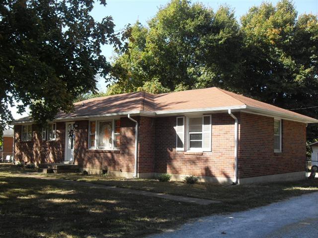

guys i am 68 and don't want to mess around on the roof
with a roof or eves mount
a j mast on side of my house would be better for me (see house)
if not this antenna how about a db8 or a db4

Given your interest in UHF only, the CS-4 will do quite well for you. It may look different but it is very similar to the DB-4 electrically. Don't be surprised if you see the high VHF signals as well. Mount it facing SE.

I agree with GUM. The Clear Stream 4 should work fine. Mount the antenna facing S/E at about 131 degree magnetic compass. Here is how to aim antennas , http://www.kyes.com/antenna/pointing/pointing.html. Avoid pointing the antenna through trees if you can. Tree leaves absorb UHF signals more the VHF signals.
