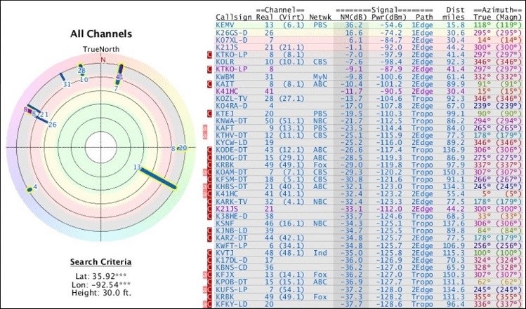

Hey y'all. I've got a friend that lives in Leslie, AR and this is his report at 30ft.
http://www.tvfool.com/?option=com_wr...90380b32be2982
This is his is report at 150ft.
http://www.tvfool.com/?option=com_wr...9038b623f6b13f

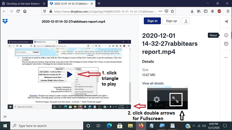

Sometimes it's slow if their server is busy. Here is a video of me doing a report for the same Zip code location. You can enter the Lat and Long in the same box separated by a comma, or enter each in its own box:
To view:
https://www.dropbox.com/s/i2ajw2qq1h...eport.mp4?dl=0
Sometimes the video takes a long time to download from Dropbox. Wait until the screen looks like this before you click on the Play triangle:
To download and view later:
https://www.dropbox.com/s/i2ajw2qq1h...eport.mp4?dl=1
I use VLC Media Player

I got the TV Fool links corrected in the original post. Could y'all tell me what you think? Thanks.
Thank you for the new reports.
This is your report for 30 ft:

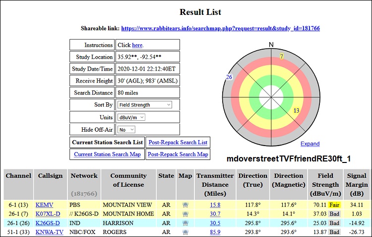

This is a rabbitears.info report that I did for 30 ft:
https://www.rabbitears.info/searchma...tudy_id=181766
I don't have the exact coordinates for the location, so the report that I did could be a little off. If you give me the exact coordinates in a PM for privacy, I can redo my report. In hilly areas, a small change in location can make a big difference in a report.
Both reports agree on KEMV. That should be the easiest to receive. It will require a VHF-High antenna like the Stellar Labs 30-2476 and a preamp.
This is the terrain profile for KEMV. VHF signals can make it over rough terrin better than UHF signals.
The other possible channel will be more difficult to receive. The two reports don't agree. It will be either K26GS on UHF real channel 26 or K07XL on VHF-High real channel 7. They both have the same subchannels.

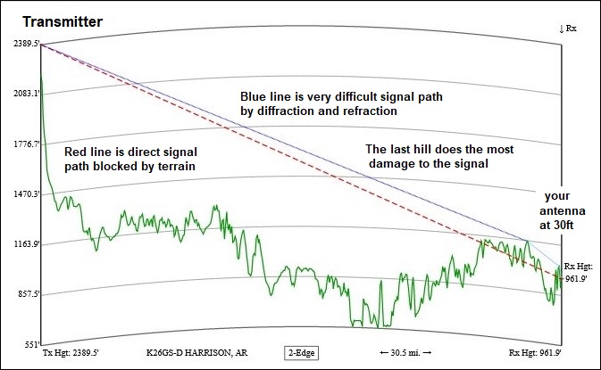

K26GS will require a high gain UHF antenna like the HDB91X and a preamp to even have a half a chance.
K07XL will require a second 30-2476 antenna and a preamp.
I don't see any other possible channels at 30 ft, but reports with weak 2Edge signals are known to be less accurate.

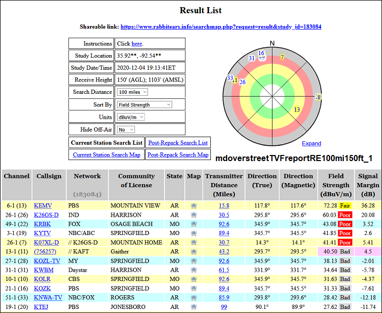

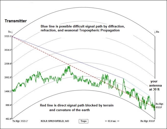

Hey Rabbit. If you extend to 100 miles on the rabbitears prediction, what does KOLR look like?
Old 4-Dec-2020, 11:44 PM   #10

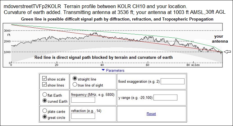

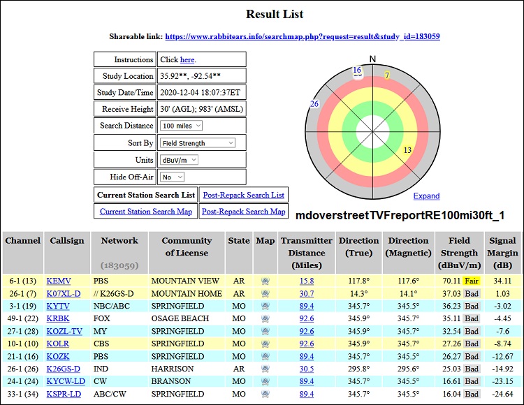

Good question. It looks difficult, but not impossible and they have an application in for a power increase. I also see KYTV and KRBK.
https://www.rabbitears.info/searchma...tudy_id=183059
Using different profile software for the same signal path:
This report is for 150 ft:
https://www.rabbitears.info/searchma...tudy_id=183084
File Type: jpg mdoverstreetTVFreportRE100mi30ft_1.jpg (178.5 KB, 3374 views)

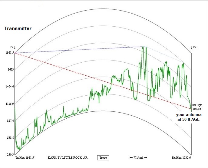

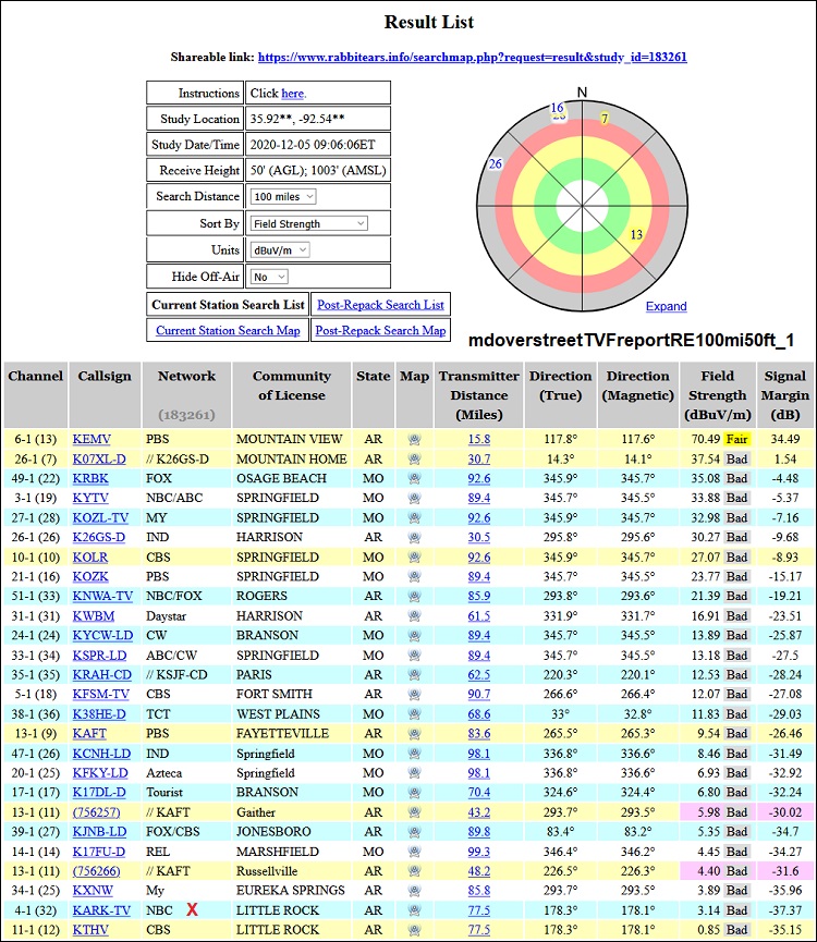

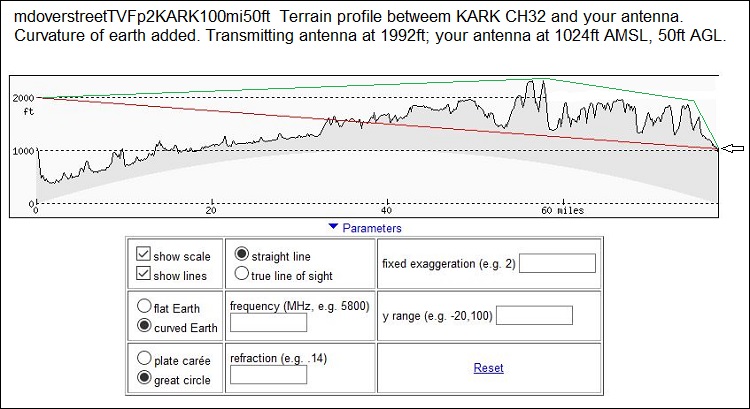

.....would you mind making one of those reports for Little Rock channel KARK since that was one he was wanting to receive. I'm kind of curious to find out where the Little Rock stations are being completely blocked.
I used RadarScope's distance tool to measure out 36-38 miles from KOLR's tower. Looks like it slammes into a mountain about 20 miles east of Branson.
He told me he can go 50ft.
Here is a report for 100 mi and 50 ft:
https://www.rabbitears.info/searchma...tudy_id=183261
Very difficult signal path; doesn't look promising.
