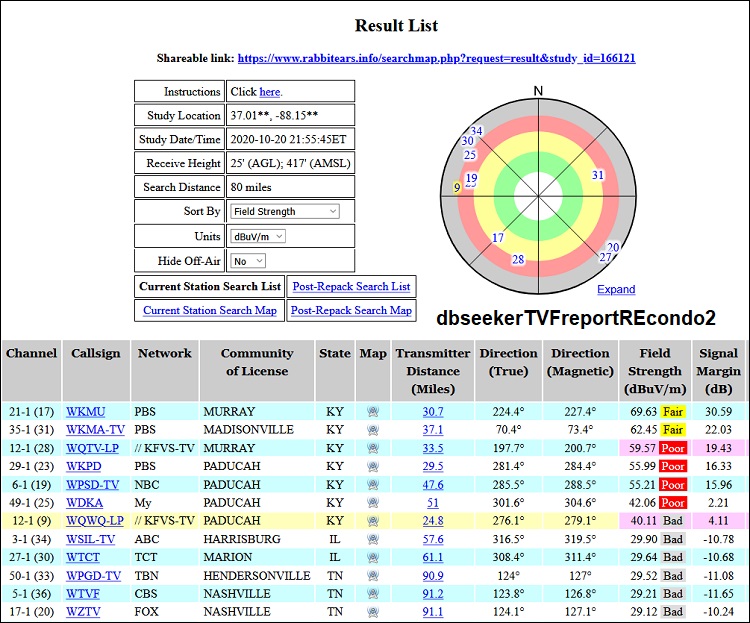

Hello, dbseeker; here is a rabbitears.info report for your Lake Barkley location:
https://www.rabbitears.info/searchma...tudy_id=166121

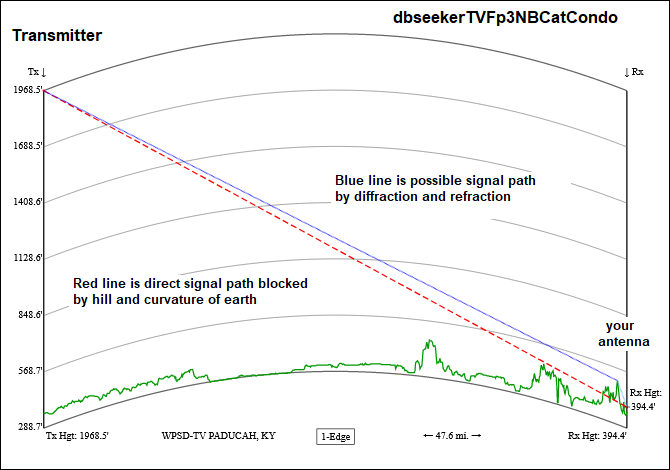

The NBC signal is fairly weak, but it is better than the rest of the major networks. There is a hill in the signal path just before your location:
You have a good chance of receiving NBC with a high-gain outdoor antenna in the clear.

Many thanks for the replies. It would appear at a -11db Nashville reception strength from the Rabbitearsinfo, that even with a 4 db improvement of the cliff, reliable reception with even the highest gain UHF antenna would be quite a stretch. The expertise and insight of the experts here are amazing.
