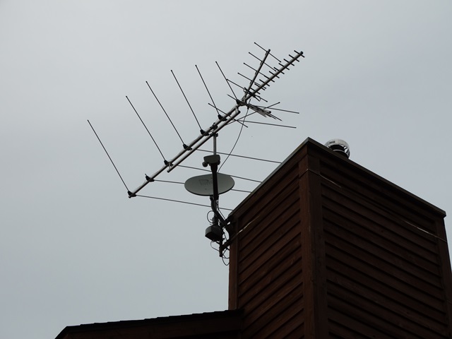

A friend of mine wants to cut the cord and already has an OTA antenna installed 14 years ago. He had since had satellite and now has cable. He has already tried it out after not using it for years, but his reception is spotty.
He gets Virtual 50.1-50.4 (real 51) & 9.1-9.3 (real 19) and that's it. He claims he used to get many other channels. Looking at the TV Fool report, he should get many, many more:
http://www.tvfool.com/?option=com_wr...e2cb8ab62580e2

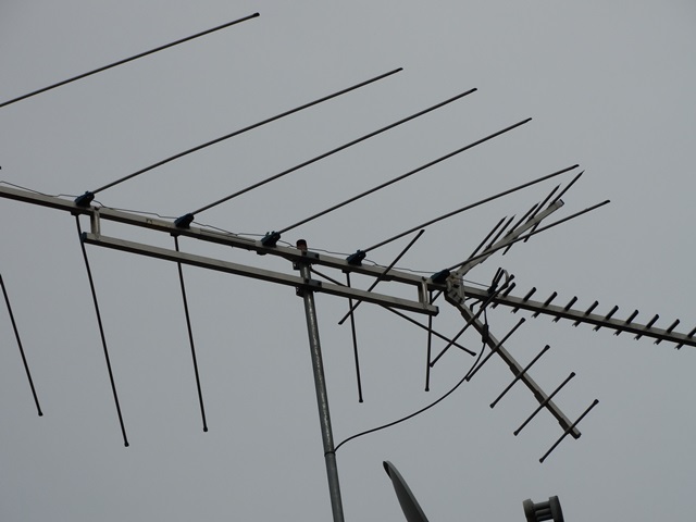

It appears to be a Radio Shack VU-120XR PN#15-1644 mid range antenna. One element is broken off close to the main beam and another was folded back, which I put back in place but couldn't secure it there as the rain started to fall.
Radio Shack VU-series:
OK, after looking at the signal meter it appears that he's about to fall off the digital cliff barely pushing 50% on 50 and 9. He said he used to get other channels, including 7.1 WLS (real channel 44) which should be the strongest. My opinion is that the broken element on the antenna shouldn't affect the bulk of channels which are UHF except for 2.1 (real 12).
Back when he first installed the antenna, I doubt the white pines directly in the signal path were in the way. They are 40-50 feet in the distance. I didn't get a picture as I was just checking his rotator. It's an old Radio Shack, in my mind, one of the better ones from the time period 2000 or so.
I find it hard to believe that real channel 51 comes in reliably but real channel 44 doesn't even move the TV signal meter.
At any rate, I think it may be an issue with the trees, plus his chimney mount puts the stainless steel furnace and fireplace very close to the antenna when aimed at Chicago.
Maybe just a new antenna, preamp (50+ feet of RG-6) and 5 feet more of mast? A new rotator if he wants Milwaukee, and I'm sure he'll want VHF too...
We haven't even discussed Milwaukee since his rotator isn't working.
Any suggestions?
Thanks, Bob

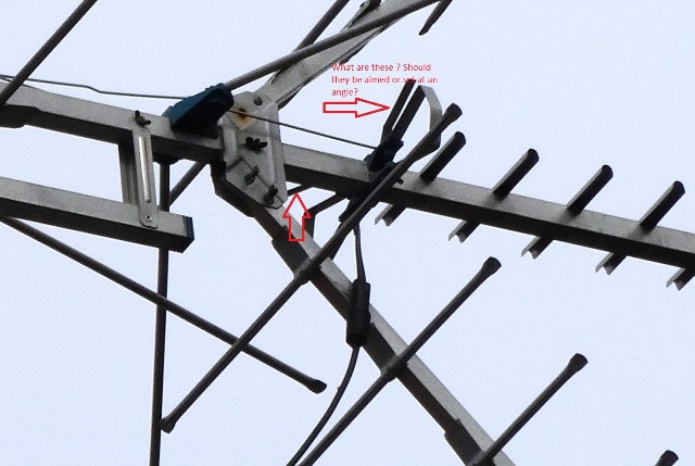

What are these?
Also, I noticed that these little "wings" were not symmetrical, I believe the wind has moved them. They will adjust, Rivets are not too tight.
What are they? FM antennas?
At any rate should the be adjusted perpendicular to the boom, or how?
Thanks again!

The first thing I would do is get a compass out and make sure it is pointing in the right direction. The Dish guys may have moved it when they installed their hardware. Then I would run a commercially terminated piece of RG6 right from the antenna to a television and make sure the problem isn't with something between the antenna and the television.
Good idea. With an installation that old, the antenna and the feed line are both suspect. You need to find out which is defective.
The trees might also be part of the problem.

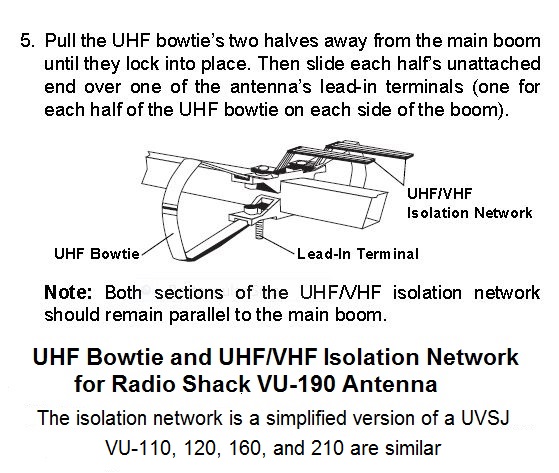

What are these?
They look like the shorting stubs for the UHF/VHF isolation network.

Isolators the problem?
Hi Rabbit,
Interesting. I can tell you right now that those isolators are not as the diagram you posted shows in fact, they are at least 90 degrees off.
In your experience could that be most of the problem?
Thanks, Bob

Thumbs up Could he be picking up those 2 channels without an antenna?
Hi Wizwor,
Thanks for your input .
You may be right about the RG-6, but I had disregarded that because he is at least getting some channels, but definitely important to see if that is the issue.
Could he be picking up those 2 channels without an antenna? The transmitter is 40+ miles away but on the tallest building in Chicago though.
The aiming of the antenna probably isn't the issue, because he sat in front of the TV while I moved the antenna and we talked over our cell phones.
The trees, also may force him to put a taller mast up and a larger antenna with a tip up adjustment. No decisions on that yet
I doubt it.
There are a number of possible causes for poor reception. It could be one, or two, or all. You will need to make some equipment substitutions, one-by-one, with known good parts to determine the cause, even if it means you end up with a completely separate antenna system with a different antenna, new coax, and a different antenna location.
Right now you are just guessing; you need to do methodical substitution troubleshooting.
If you think that what I'm suggesting is a lot of trouble, it couldn't be any worse than what you have done so far.

Start with a new matching transformer (balun) and a new length of RG6 coax. At nearly 15 years of age, the odds are high that one or both have suffered water infiltration or corrosion.
Lowes now carries an inexpensive matching transformer (RCA brand), it appears to be identical to the one that Winegard is using on their production of RCA-branded antennas. It performs well, but the leads are very fragile and care is required to keep from breaking the wimpy spade lugs or wire leads.
BTW, is he re-using the coax from the satellite install? If so, were any sat-specific devices (multi-switch, diplexer, etc) removed first? Failure to do so is a common failure among sat-to-antenna transition projects. We get those calls all the time.

A couple of questions: I noticed a rotator motor on the mast: is it still functional? Do you have the controller? You may want to sync up the rotator to facilitate aiming the antenna. It also appears that he can get the Milwaukee stations by rotating the antenna after the things that ADTech suggested have been tried.

I may have mentioned in the original post that the rotator doesn't work. The indoor part seem to work, the dial moves when turned, and the motor in the control unit moves and audibly sounds like mine at home. I pulled the cover off the bottom, all wires are intact. I wiggled the mast while the owner actuated the rotator control, nothing happened. He needs a new one. Maybe. I have a voltmeter but don't know what to look for. He could just need new 3 wire lead.
Milwaukee would be a bonus.
