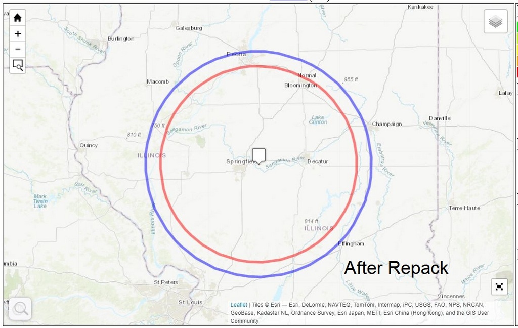

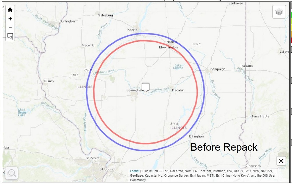

Hang in there, it might get better. From the RabbitEars info, it looks like they are scheduled for the phase 9 repack and will be moving from physical channel 44 to 16...and will also get a bit of a power increase and a higher antenna. Phase 9 is scheduled to be complete by May 1st. See the before and after coverage maps.

Thanks for that rabbit ears link, that certainly made things clearer. Especially your additional info you provided with a positive outlook. Looks like I will want to occasionally rescan and see what I get.
