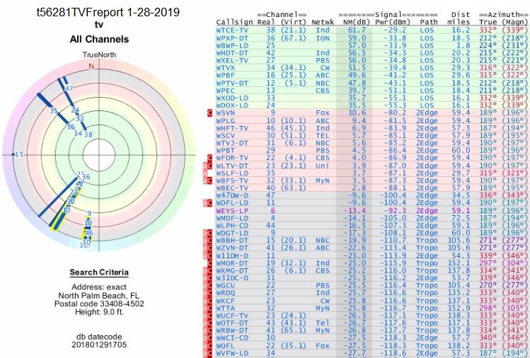

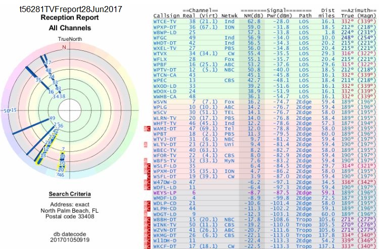

I also found it strange that my signal analysis results are different now compared to my results from a couple of years ago. Here are both signal analyses:
TVFool is using a defective database with many errors to generate signal reports. This is your previous report:
This is your current report:

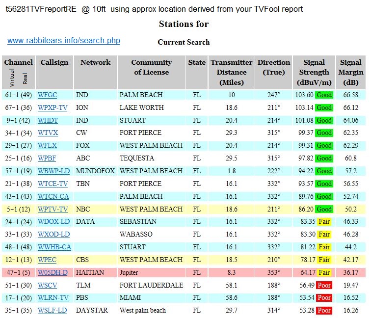

This report, from rabbitears.info, should have a more accurate list of channels:

WFLX Fox and WPBF ABC are very strong on your report; you shouldn't have any trouble receiving them. Where is your C2MAX antenna located? Are there any trees in the signal path? Are you using a preamp?
WPTV NBC and WPEC CBS are weaker and on VHF-High channels. You might need an antenna that has more gain on channels 7-13 than the simple dipole for the C2MAX.
Another problem is that ABC is in a different direction than the other channels you want.
