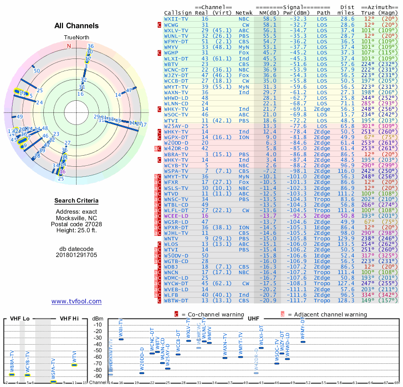

I have attached my TV Fool Report. As can be seen, I live in a relatively good area to receive OTA from both the Greensboro and Charlotte NC markets. However, I have noticed some issues that I am trying to resolve and hope one of the experts on here can point me in the right direction as far as a new antenna.
Currently, I am using a Clearstream 4 (CJM model) that purchased while living at a former home about 7 years ago. At any rate, this particular antenna is up in the attic of my new home. I've got it aimed SW towards the Charlotte market; and it doesn't do too bad picking up my true locals (Greensboro channels on the side), with some exceptions.
However, here is my objectives in order of priority. I want to 1) stabilize my out of market WJZY 46 and WCNC 36 stations from Charlotte so that I can receive both of them simultaneously without making adjustments to my antenna in the attic. And second priority is to stabilize my local WXII (NBC) channel 12. My local channel 12 tends to pixelate on windy days and sometimes other inclement weather. If both of these goals cannot be met with any existing antenna, I would at least like a scenario whereby the out of market WCNC and WJZY are stabilized so that I get a good lock in (no pixelations) on either one of those out of market stations.

Thanks for any help. My TV Fool report is attached.
PS there is a bit more than meets the eye with my TV Fool Report. It shows WXII as my strongest local station. But it is not my strongest - and my theory is that it has to do with the lower power level that the station is operating on versus some of my other locals. Also - my report shows my out of market Charlotte stations (in green) as being comparable to one another - when in reality - WBTV CBS Charlotte, NC is (by far) my very strongest out of market station. 'Much' stronger than WJZY or WCNC.

You have 2 issues to deal with before trying different antennas.
1. You have channels from all 4 points of the compass to deal with. Any directional antenna will not get them all. Unless you use a rotor.
2. Your antenna is in the attic, that makes it un-predictable at best on how any particular antenna will receive signals.
Also what about any trees between you and the towers, hills, buildings/houses?

Yes, that is true. I have 4 points on the compass to deal with. This why I was thinking about something with a very wide beam width or omnidirectional. Of course, the issue is this type of antenna may be too weak to pick up my out of market stations.
As it is now, things aren't that bad. I live in a relatively well elevated area with no trees, buildings, or homes that are blocking the line of sight in my immediate area. With my present setup (the Clearstream4) pointing to the SW for my out of market stations, I am able to get relatively good overall reception, with the exceptions I described.

The Clearstream 4 should have plenty of horsepower based on your report and desires. The problem is that in general, attic installations are hit-or-miss. First thing I would try is to get that antenna out of the attic and put it up on the roof where it has a clear LOS in 360 degrees. Aim it to 231-magnetic for the Charlotte stations, which you should be able to receive. Then see how that setup performs for WXII and other "locals" to the north and east, while still aiming SW. If you can't get those locals off the back and side of your antenna, I would try removing the reflector next, and if that doesn't work, maybe try hunting around on the roof for a hot spot, or maybe re-try your DB8e in its various configurations.
All of these tests should be done with a single, preferably new length of RG-6 (no more than 50-feet) and only one TV. No amps, no splitters--- keep it simple. Once you solve the antenna locating problem, then you deal with distribution throughout the home, which may require amplification (preferably at the mast) to overcome your downstream losses. Remember that amplification doesn't improve reception of the signals. It can only improve the distribution of signals that are first collected by the antenna.
