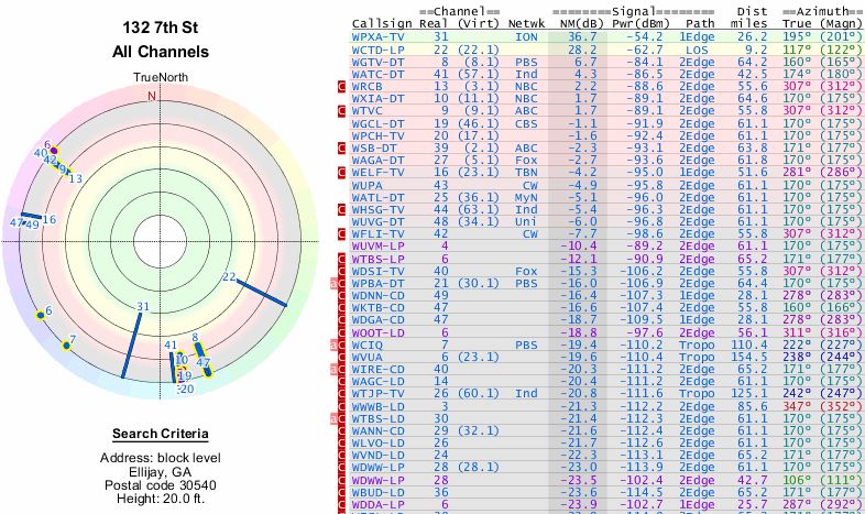

Your TV fool report was only resolved to block level, and so it is likely not accurate. Use the instructions in the sticky thread "A reliable method for generating a TV Fool Reception Report" to get a more precise report. Make sure to zoom all the way in and put the push-pin right on the RV site as seen in the satellite imagery. Enter the expected height of the antenna Above Ground Level- AGL (not the antenna type and pre-amp as prior post suggests). Also, please list the stations you wish to receive (by their call letters) so we can make a proper system recommendation.
If you look closely at his TVFool report, you will see his exact address, which is consistent with the fact that he gave the coordinates for his former location in his previous thread.

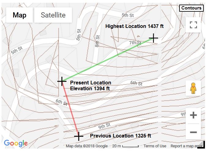

Welcome back, realjet
Your new location has higher elevation, which should help, but it isn't the highest in your area.

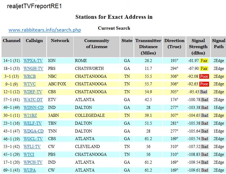

That is a good UHF antenna that will work for ION or PBS if you aim it at them, but not for your VHF-High channels from Chattanooga, real channels 13, 9, and 12.
It is the real channel number (also called physical channel or RF channel) that determines what antenna is needed.
VHF-Low, real channels 2-6
VHF-High, real channels 7-13
UHF, real channels 14-51
The virtual channel number (like 5.1 or 5-1) is a holdover from the analog TV days to maintain the identity of the station, and is what the TV displays. By convention, the virtual channel number is given in the decimal form to keep it from being confused with the real channel number.
I suggest a Stellar Labs 30-2476 VHF antenna aimed at Chattanooga and your CM7777HD preamp. It might help to tilt the front end of the antenna up a little to catch the signals coming down from the mountain peak. You can mount the preamp a little lower to reach it more easily and play with the high/low gain button.
https://www.newark.com/stellar-labs/...vhf/dp/71Y5462
If you want ION or PBS, try an Antennas Direct DB4E, combined with your 30-2476 using a UVSJ UHF/VHF combiner between the antennas and the preamp.
https://www.amazon.com/Antennas-Dire.../dp/B008PBTPN4
I can't guarantee that this will work, but it is your best chance.

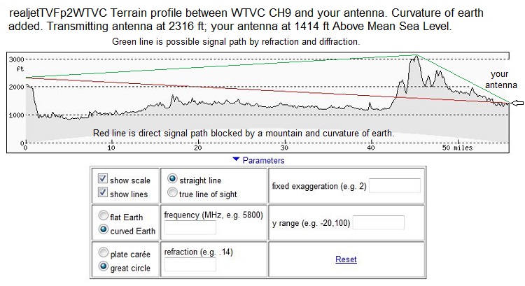

This is the problem with the signals from Chattanooga; there is a mountain in the signal path:
I agree that the Stellar Labs VHF antenna is a good choice.
This is one of those situations where you can take advantage of ground gain to tilt the signal up instead of tilting the antenna. If you can figure out the optimum height, the ground gain can be as high as 6 db. For this to work, the slope of the land in front of your antenna must also be considered. The angle from your location to the mountain that will reflect the signals from WTVC is about 2 degrees uptilt.
http://www.qsl.net/oz1rh/gndgain/gnd_gain_eme_2002.htm
