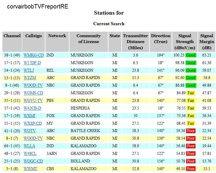

If he hasn't moved, I think this is good (or as good as TVFool can get it):
http://www.tvfool.com/?option=com_wr...9038ca707e6770
He started with combining "150-mile" antennas; now I think he is using an 8-bay with the panels aimed in different directions.

There are two channel 29s. One in Grand Rapids and one in Muskegon. They can interfere with each other, especially when combining antennas aimed in different directions. In addition, the channel scan function of your tv may be confused because both channel 29s send their PSIP as channel 29.

Both channel 29s are low power stations, so the range is much less than full power stations.
Multipath in digital can not be seen as ghosting, it simply prevents any reception.
Mileage ranges on antennas is simply advertising puffery. You can’t design or troubleshoot a problem based on best-case reception.
If you aim an antenna at either 29 WITHOUT another aimed at the second 29 and rescan, what happens?

now and then 8 comes in as 8 but they are also 29 and they are working to improve that north east tower. i'm not a first name basis with steve the engineer there
one thing i have pointing to the south east is a power xformer on the pole just about directly in my way. this past aug that xformer burn out and they replaced it and
the channels now are better. so that xformer must have been disturbing the signal.
You asked in 2016 how there could be 3 different sources of Fox 17 shown on the charts. That station has many different towers, more than either WOOD TV or WXSP. Yet their management chooses to have almost all their extra low-power towers map into TVs as 17.x--confusing, isn't it?
You also mentioned about having a preamp and distribution amplifier. If you do try just a single antenna again, I'd suggest first not having the preamp nor distribution amplifier in place. Just have the antenna's downlead coax go to a single TV. If you can get a picture coming through from most of your problem channels, then add the preamp in (what brand is it)? Note that it's not too common that people need both a preamp up on the mast, and a distribution amp further down the line--usually it's only one or the other.
did that as i have a tv in the garage on the wall next to my antenna system. and that one show the power with one button on the channel being use at the time and
i have tried all the things you talk about. the mast amp did not work at all i have a channel master preamp and all i use now is the power supply it works better that
the amp system why take a guess. and i have a distribution amp to have 4 tv's in use
I hope some of my thoughts help you Bob. I and others are interested in hearing back on any progress you make.
Cheers!
corvairbob

Hi Bob,
You're welcome for the help. Those of us watching this tread learn more information from each of your posts.
See if I'm understanding correctly:
* Your garage is the unattached building kind of in the back yard, when I zoom in on your address on Google maps. No wonder you don't want to run coax through the air from on top of the house to the garage. (I had mistaken the lower southern portion of your home for being an attached garage.) Thus, improving reception their doesn't help you and the family inside the home.
* You can point an antenna north and not have trees blocking its line of sight to one of the Muskegon TV towers. But the trees are in the way for the tower to the northeast.
* When you point the other antenna to the southeast, it lines up with the power line transformer. (Glad they upgraded that, as apparently the older one was basically leaking radio wave energy more than the new one.)
* You have some sort of power supply in line, with it being closer to the antennas than the distribution amp.
Please advise if I have any of the above incorrect. It would affect how I ask these next questions. Please also don't be offended with these questions--I'm wanting to help.
> Are you sure you have the two TV towers north of you in mind correctly? Both TV Fool and the RabbitEars chart that Rabbit73 included above note that both the 17.1s that you might receive are at 18 degrees True North (around 24 degrees magnetic), and that the 8.1 (real frequency 46) and 29.1 (RF29) are closer to Wolf Lake, at 67 degrees/73 on a compass?
> Do you still have the RCA Yagi that you showed the picture of in the 2016 thread? If you point that to the southeast, and have only its coax go to the distribution amp (without the combiner), does that ever get you 8.1 (NBC from WOOD) or even 3.1 (CBS from WMMT)? Those would be their main signals from the Gun Lake area. It has the wider dipole elements that are needed for Hi-VHF, unlike the HDB8X that is optimized for UHF.
> If you drive around your neighborhood, what do you see up on other people's homes, and in what direction? My guess is that many have the longer yagis like you noted in your 2014 thread (the Winegard HD 7698P, although you likely wouldn't need one that long). I've geeked out so much on OTA that my teenage son rolls his eyes when I'm glancing at people's roofs and comment on their aerials.
Cheers!
i had steve from tv8 send me the address and inputting that into google shows it just north of the
muskegon river. i can go out to the road and see the end of quarterline road and then less that a 1/4
mile to the river so doing a measurement i got about 6 miles to the tower. fomt my house
tv8 channel 8.1 is to the east and that power pole must not let it come thru all the time. in the mornings
it comes in athen as the sun goes up that station goes away.
i have that but if i take it out of the system tv35 and 54 fail to come in for me. and 3 is just
possible.
i one time tried to just use 1 antenna and rotate it but then everytime i did i had to re scan. that was
just a pain. none of my tvs seem to be able to let me punch in the channel and have it remain in the
tuner. so i would have to punch them all the time. no i can do that i guess but they don't have the .
for the sub digit.
i drive around but i do not see any antennas on any roofs. in my area. there may be a few i have
not yet seen any
so now it seems i can't get pictures uploaded here like before if i can figure that out will send some along.
