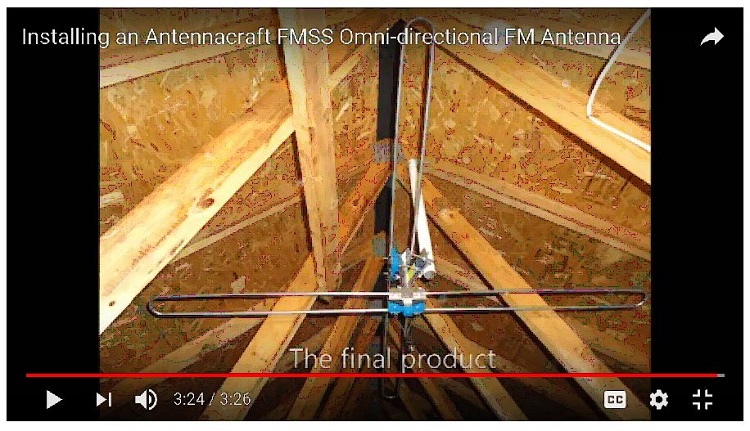

I know this isn't OTA related, but hoping somebody can give me an answer, since I'm already registered here.
I'd just like to know if this Rat Shack has a sweet spot when aiming.
Thanks guys!

Crossed dipoles form a turnstile antenna. In theory, it's a pretty good Omni with peaks at 0, 90, 180, and 270 degrees. There are slight nulls between those directions.
https://www.google.com/search?q=turn...iw=911&bih=363
But holl_ands modeled it, showing that it is a little less Omni that theory indicates.
https://imageevent.com/holl_ands/omni/fmturnstileacfmss
I don't do modeling, but that doesn't look like a 90 degree phase shift line between the crossed dipoles, so I don't have confidence in his model. How long is the feed line between your dipoles?

The feed line is about 8", but the output is not centered between the two.
It is connected to one dipole, which is jumpered to the other dipole.
Not sure if this would affect the phasing though, at this low freq.
So, zero degrees is off the end of the loop, or perpendicular to it?

That is the correct way to wire a turnstile antenna.
In theory, perpendicular to either one of the dipoles, but I think you might need to make some aiming tests for your favorite stations.

MKE and Chi are almost a perfect 180 apart from me, so adjustments should be a snap. I'll probably just clamp a mast to the gable end of my garage, since I don't really care to climb the towers.
