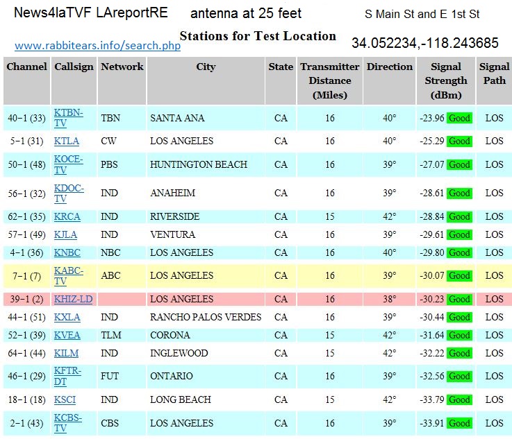

I don't see the CBS OandO station for Los Angeles? KCBS Virtual channel 2. I know it is on the Air because I watch it every day.

Yes, you are correct; KCBS doesn't show on a TVFool report:
http://www.tvfool.com/?option=com_wr...9038e71a22e609
but it does show on a report from rabbitears.info:
TVFool is using a defective database to generate reports. The story is here:
http://forum.tvfool.com/showthread.php?t=16376
The TVFool site has a small staff; I doubt that any corrections will be made. The reports seem to be on "autopilot."
The problem has become worse because of many changes being made as a result of UHF Repack.
N4MJC (username Trip in VA on forums) runs the RabbitEars.info site. He now works for the FCC, so the list of channels on a rabbitears.info report is much more accurate than on a TVFool report.
