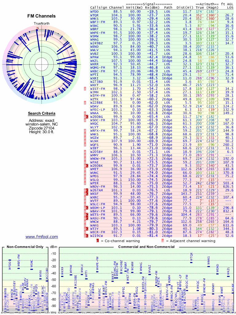

The signal strengths of the FM stations are likely to overload the 7777 preamp unless you live in a remote area.
Please post your TV fool and FM fool reports.

I appreciate the reply. I had thought about overload; however, I keep my TV antenna (almost always) pointed toward the SW for the longer range stations (Charlotte). I only point it to the SE in the unusual cases where I can't pick up my true locals on the side (Greensboro/Winston-Salem). So I figured the CM7777 preamp would be fine; and perhaps even improve things on a couple of my longer range stations when they are prone to pixileate.
My main concern was interference if I mounted an FM antenna right below my TV antenna (Winegard 9095P). I thought that could potentially cause interference with a single coax out of the preamp down into my house.
I don't want to do anything that would potentially mess up the TV setup since that is what is most important to me. Thanks for any additional feedback.
http://www.tvfool.com/?option=com_wr...5747d6ae64c870
