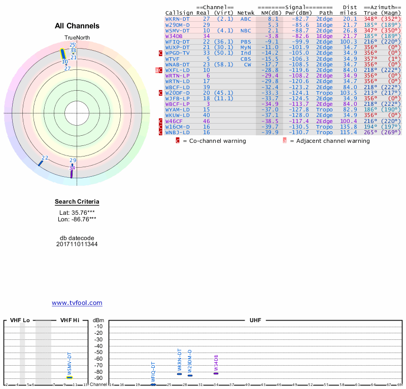

I have also attached the all channels report.
This is what it gave me when putting in our address: http://www.tvfool.com/?option=com_wr...60edc5d0bc9a87
This is what it gave me when putting in the coordinates: http://www.tvfool.com/?option=com_wr...60ed7ab145a23a

Thank you for the coordinates; you do excellent work, Theresa. I will study the report.
Entering an antenna height of 25 feet makes the signals look a little better:
http://www.tvfool.com/?option=com_wr...60ed9d4ce4d8da

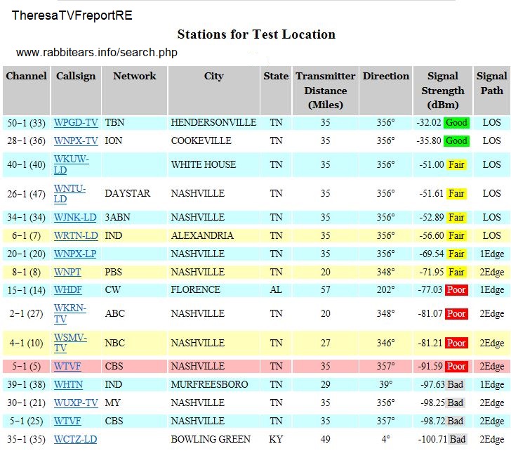

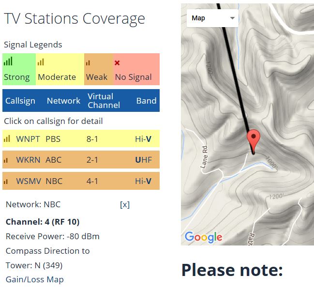

This is an extract of your report:
This report is from rabbitears.info:
And, for comparison, this report is from the FCC DTV map site:
The reports are different because the database for the TVFool report has errors and the prediction software used is having a hard time calculating the signal strengths because you are inn a valley behind a hill.
The TVFool report only shows CBS on real channel 5, which would require a BIG antenna like the Winegard HD8200U. The rabbitears.info report shows CBS on 5 and also UHF real channel 25. The FCC report only shows UHF channel 25. IF you are able to get CBS on UHF channel 25, then you can use the Winegard HD7698P antenna. Either antenna will requite a preamp like the Antennas Direct Juice or the Channel Master 7777HD/Amplify which has HI and LO gain settings.

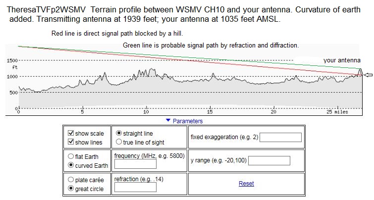

This terrain profile shows the hill in the signal path.
This shows your location in the valley:
Difficult, but maybe not impossible.

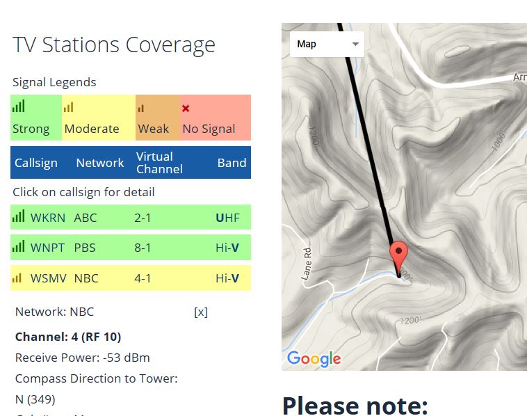

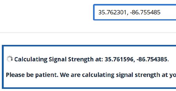

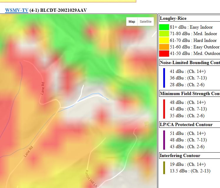

You are correct; I didn't notice that. I had entered the correct coordinates, but the FCC DTV site changed them:
I redid it and moved the marker to your location. The signals are weaker:
So most likely we won't be able to get service so do I even try or is it just a waste of money? Is it worth trying the Winegard HD7698P antenna with a preamp (Antennas Direct Juice or the Channel Master 7777HD/Amplify) are necessary and it should be at least 25' up facing south?
The computer simulations are having a hard time with your location; it is difficult to predict what you will be able to get.

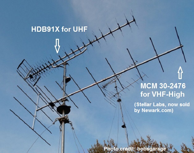

Forum member bobsgarage lives between Chicago and Milwaukee. He put up two masts, one for each direction, but the antennas were aimed in about the same direction when he took the photo. This is what the 30-2476 and the HDB91X look like up in the air.
Video for HDB91X assembly:
https://www.youtube.com/watch?v=fEnIbVxxKH4
This shows the tilt bracket. With the adjustment nut on this side of the boom, the front of the antenna can be tilted down. If you need to tilt the front of the antenna up, the adjustment nut should be on the other side of the boom.
