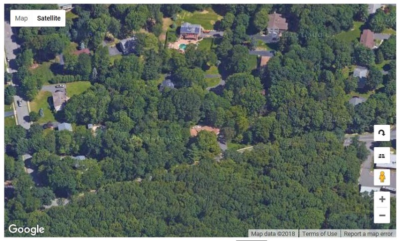

About Three years ago I posted this same question and got some very good responses, however I never got around to following through with my purchase and installation. Since I last posted some of the suggested antennas have been discontinued and would like some updated suggestions for antenna, splitter, amp, rotator.
I am on the top of a hill but there is lots of large trees. I would like to have as many channels as possible on 4 tv's. I will be installing outside on the chimney or a gable end mount about 25' from the ground. Thanks in advance, Eric

If you still want WJLP MeTV, then you will need an antenna that covers VHF-Low, real channels 2-6.
http://www.rabbitears.info/market.ph...&callsign=wjlp
Your signals are strong, but the report doesn't take into consideration the trees; it assumes your antenna will be in the clear. Trees block TV signals, so it is difficult to predict your reception results. If it weren't for the trees, I would suggest the Channel Master 3016/Advantage 45, but I suggest you upgrade to the 3018/Advantage 60.
https://www.channelmaster.com/Digita..._p/cm-3018.htm
I see a lot of trees in your area.
