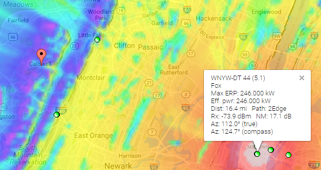

When I run the interactive tool report most stations are in the cyan and blue color area, including WPIX and WNYW. When the signal hits the first mountain here in NJ it goes from Red-yellow-green to cyan and blue. And I'm past the second mountain, which is all cyan and blue. Not good! I attached the interactive map for your reference. Still not sure why the other channels come in and not others if they originate from the same location.

Old 3-Nov-2017, 3:41 PM   #4
Please run the interactive process, then generate a new plot. Post the LINK to that plot as per the sharing instructions on that web page.

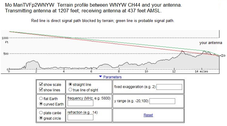

WNYW is pretty far down the list with terrain interference. I think you need an antenna with more gain. Some of the 751 antennas are actually a redesign that is the 7511, but is sold as a 751. It isn't as good.
Is the LNA-200 up by the antenna or down below?
You can see the terrain interference to WNYW in this profile:
I'm at 346 elevation and here is my report
I had to estimate your location to do the profile. I got 437 ft elevation including 30 ft AGL for the antenna. My guess could be off.
In order for us to be of further help, you would need to give me or ADTech the exact location of you antenna in a PM so that we can look at the satellite view to see any objects in the signal path.

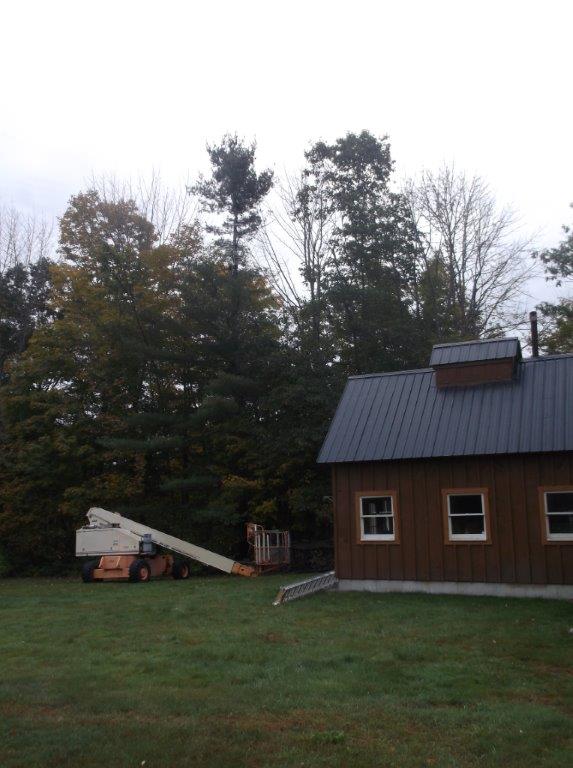

Your photos edited:

It looks like ADTech's evaluation is correct. You have terrain interference as shown in the profile and I see many trees.
