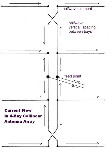

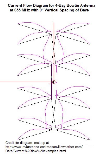

The yagi antenna has a bandwidth that is much less than a bowtie antenna, because the yagi is a high "Q" antenna as compared to the bowtie antenna which has a low "Q," as defined by the max allowable SWR over the required bandwidth. The bowtie antenna is a member of the collinear array family, which you will read about in the ARRL Antenna Book.
Here you see the collinear array with straight wire elements. The >< shape "whiskers" make the bowtie antenna even more broadbanded.
When designing a Yagi the element length and diameter must be carefully controlled for max gain at the desired design frequency. Each element must be resonant at a certain frequency. The director elements are shorter than the driven element, and the reflector element is longer. Larger diameter elements must be shorter for the same resonant frequency, and larger diameter elements make the yagi more broadbanded to cover a wider frequency range.
Computer modeling will give you the optimum element length, diameter, and element spacing for a yagi; much better than trial-and-error.

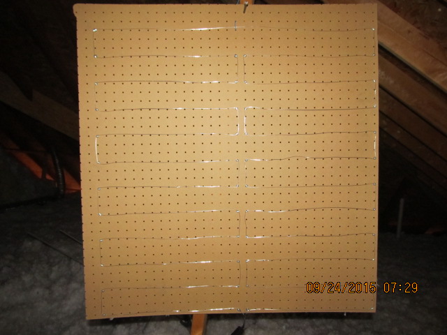

Constructed one with five repetitions using small caliber copper wire and put in my attic. Receives all local channels but signals are strong at 25 feet AGL from 44 to 74 db.

Please find attached pic of the antenna in the attic. Actually made of aluminum wire and certainly not made with extreme tolerances. Each vertical distances and gaps are all 3 inches. Other than the top contiguous length, all other horizontal sections are 16 inches and the very bottom with balun attached. Have it fed to a Samsung plasma tv in garage with just vertical bar signal strength meter. Unfortunately nothing more precise.

Thanks for the correction, the photo of your creation, and the tvfool report.
That scale is a lot better than nothing, and good enough to make comparisons.

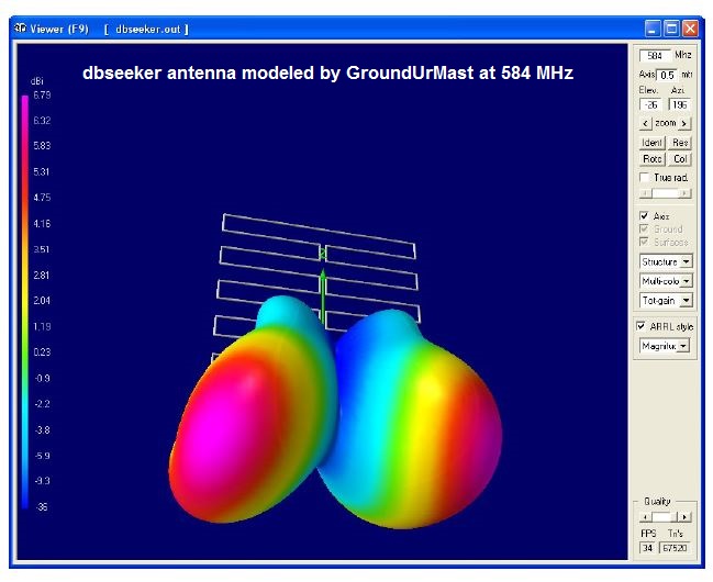

On another note... I tossed a simulation of your earlier antenna (post #10 of this thread) together, using 4NEC2

GW	504	3	-33/2	0	24+AGL	-33/2	0	27+AGL	#16
GW	505	33	33/2	0	27+AGL	-33/2	0	27+AGL	#16
GS	0	0	0.0254
GE	0
GN	-1
EK
EX	0	100	17	0	1	0	0
FR	0	0	0	0	584	0
EN
The impedance is quite high making for a very high SWR.
Also, the pattern does not project front and rear as one would expect a panel antenna to do. Rather it has 4 lobes pointing downward... (see the attached 3DView which is from a perspective below the antenna.)

Old 26-Mar-2017, 7:15 PM   #19
Originally Posted by dbseeker View Post
To me, at least intuitively, the shorter the reflector distance, the less likely the reflected signal would be out of phase.
I was concerned about a similar problem with a 4-bay UHF bowtie antenna. As the wavefront reaches the antenna, current is induced in the elements of all four bays at the same time. However, the current from Bay No.1 has to travel along a half wave section of the phasing line before it reaches Bay No. 2. The current changes direction every half wavelength, so the phasing line is reversed to compensate for that, but isn't the current arriving too late?
The answer to the dilemma is that the currents rise, fall, and change direction in all the elements at the same time, which is another way of saying that they are in phase.
http://www.m4antenna.eastmasonvillew...0examples.html
