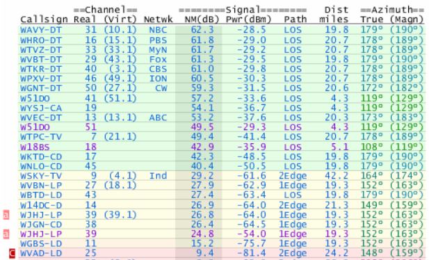

I am a complete newbie to the OTA tv. I live in NorthWest Georgia where the maps on this site show most of the local channels to be 40-55 miles away. I don't have any trees in front of my house for about 300ish ft. My house faces the same direction as the signal. My Internet source is 4glte to router then wifi so I didn't know if they would interfere. I would like some advice on what hardware to try. I would like to try to install attic if possible. I definitely do not have room for a 12 ft antenna up there but 5-6 ' is possible. I have R6 cable and a SWM splitter I'd like tie in to if possible coming from my Directv satellite. I will try link the map information. Thanks in advance.
http://tvfool.com/?option=com_wrapper&Itemid=90
http://www.tvfool.com/?option=com_wr...e6a4877a9ab45c

I would suggest you keep things simple, especially at first. Most of
your stations come out of the Atlanta market. I would aim for those
stations using a Winegard 7694p antenna using RG6. That antenna
is available at either Walmart or Home Depot .com for less than
$50.00 including shipping. Run that cable to ONE tuner and see what
you get. Be sure to keep your cable run as short as possible. Runs
over 50 feet cause problems you'll want to avoid. Later, you can
add other tuners or perhaps another antenna pointed toward the
multiple transmitters to your Northnorthwest.

A well-selected amplifier located close to the antenna can improve the system noise margin by the (difference in noise figure of the amp vs the tuner) plus (all downstream insertion losses). That means that very weak signals otherwise just below the noise floor at the tuner's input can be raised enough to make them receivable.
As an example: Assume a tuner NF of 6 dB (probably fairly typical) and a preamp NF of 2 dB. Before the coax, one would already enjoy a 4 dB improvement in the system NF. Add in 50' of RG6 (3 dB) or 100' of RG6 (6 dB) or a 4-port splitter (8 dB) and it's illustrative as to how a weak signal which would otherwise lost in the system, can be preserved enough to be receivable.
Old 29-May-2017, 11:14 PM   #15

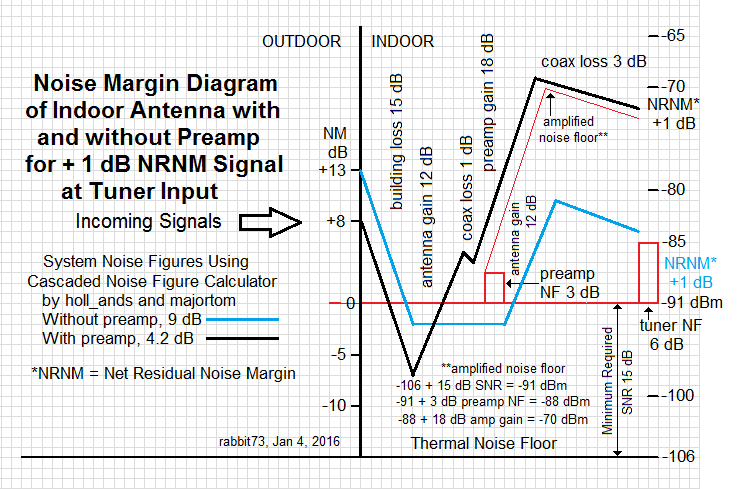

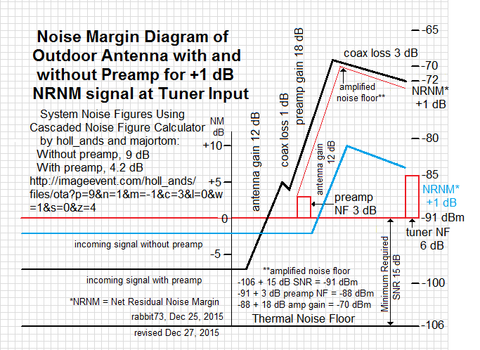

This is where the -91 dBm comes from:
The Thermal Noise Floor for a DTV signal is -106 dBm (-15 dB NM). Any signal that is weaker can not be received; an antenna with more gain can not "pull it out of the noise." If you are able to receive a signal with a NM less than -15 dB, either the tvfool report is wrong or the signal has been enhanced by Tropospheric Propagation.
To that you must add the minimum required SNR of 15 dB:
-106 dBm + 15 dB = -91 dBm, before allowing for the preamp Noise Figure
If you do not use a preamp, then you have to add the tuner Noise Figure which is 6 dB average:
-106 dBm + 15 dB + 6 dB = -85 dBm; which is where most tuners will drop out

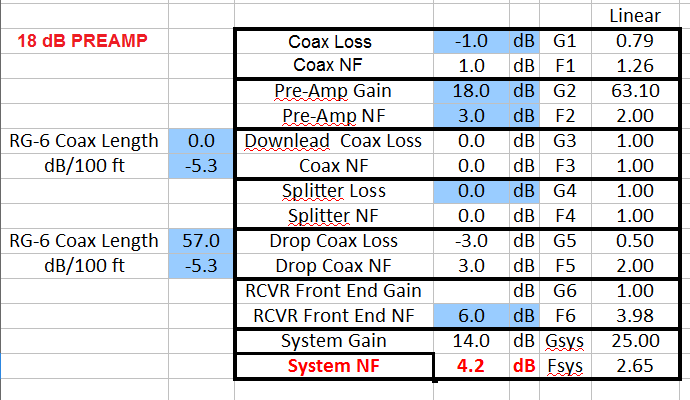

What is going on is that the antenna gain must make the signal strong enough to allow for the minimum required SNR of 15 dB and the Noise Figure of the preamp. Once the signal is strong enough for the preamp input, it will compensate for the distribution losses and bury the tuner Noise Figure in the much stronger amplified Thermal Noise Floor.
In the case where no preamp is being used, the antenna gain must make the signal strong enough to allow for the distribution losses and the tuner Noise Figure.
Maybe a few diagrams will help.
Indoor or attic, with and without a preamp:
Outdoor, with and without a preamp:
You can see how damaging attic/indoor loss is, You can also see how a preamp makes it possible to receive weaker signals, by about 5 dB.

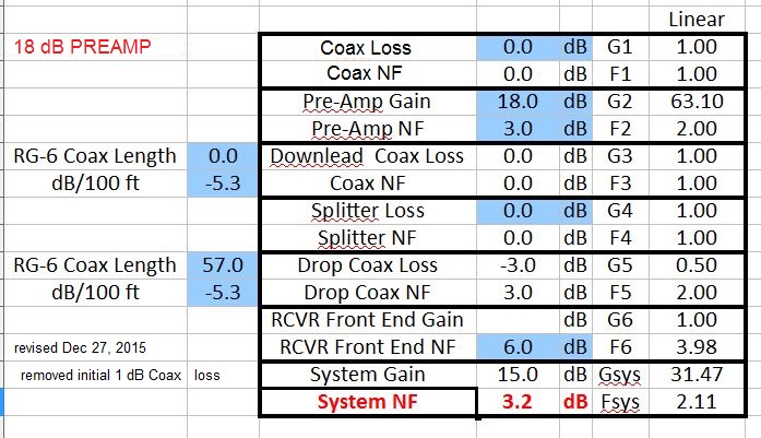

This is what a System Noise Figure calculation looks like with and without a preamp.
reducing coax loss between antenna and preamp:

Most indoor antennas are pretty good for UHF, not as good for VHF-High. That is because the elements for VHF-High need to be 3x as big as the elements for UHF.
I'm using a GE 34792 Attic antenna indoors with an RCA TVPRAMP1R preamp but my channels are stronger than your channels. Channel 13 is my weakest and it is VHF-High. The GE antenna only has a folded dipole for VHF-High; not much gain. It requires assembly, so it would be difficult to return it.
The Winegard HD7694P is only $15 more and it has much more gain for VHF-High and UHF. After you unfold it, it would also be hard to return.
My report:
I think it's worth trying an indoor antenna with a preamp if you have an east facing window without a metal screen or low-E glass, but you will probably need to put an antenna outside.
If you had to use the attic, you would need an antenna with more gain and a preamp. If the signal loss in the attic is great, even that might not work.
You must be prepared to experiment if you can't put an antenna outside.
