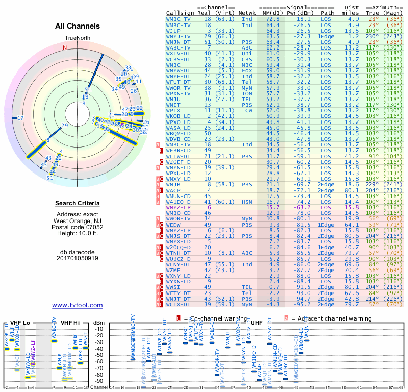

This is my report.

Thanks for the image of the report. Not quite as useful as an active link, but it shows very strong signals at your location.
Are you using any satellite distribution equipment between the antenna and the TVs?
What indoor antenna are you using?
Are you using any amps?
Your outdoor antenna is suitable for your location. It looks like the RCA ANT751. Some sellers are sending the modified version which is not quite as good called the ANT 7511. The pictures on the box are the same; the only way you can tell is that the 751 is in a long box; the 7511 is a short box. Either one is OK for you.
Your signals are strong enough to cause tuner overload, especially with a TiVo.

OTA signals constantly vary in strength. If you are just on the edge of overload, that would explain your results.
I did a report based on your image. An active link allows us to click on a callsign for more information about a channel.
http://www.tvfool.com/?option=com_wr...e6a487e7239505
Without any more information from you, I suggest you try an attenuator in the coax.
