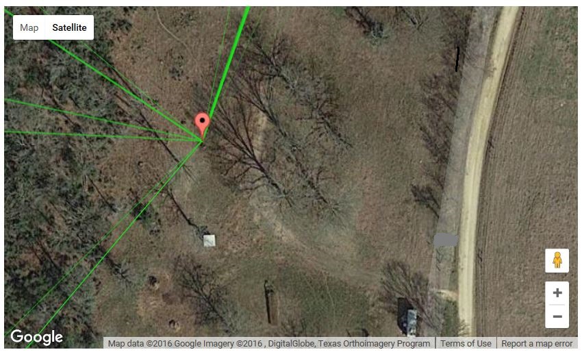

Thank you for the additional information about your location. When I look at the satellite photos, I see your location at the end of an access road off the main road.
The satellite image from the tvfool interactive map browser, using Google maps, was done in the winter when the leaves were off the trees. The image from Bing maps, if I have the correct location, shows a lot of trees that might block your signals. You will need to find a location for your antenna that avoids the trees as much as possible.
A high gain UHF antenna aimed at about 14 degrees magnetic and a preamp should work. My only concern is about NBC. If KTAL is too weak, you will need a rotator or a separate antenna, and single channel injector for KETK.

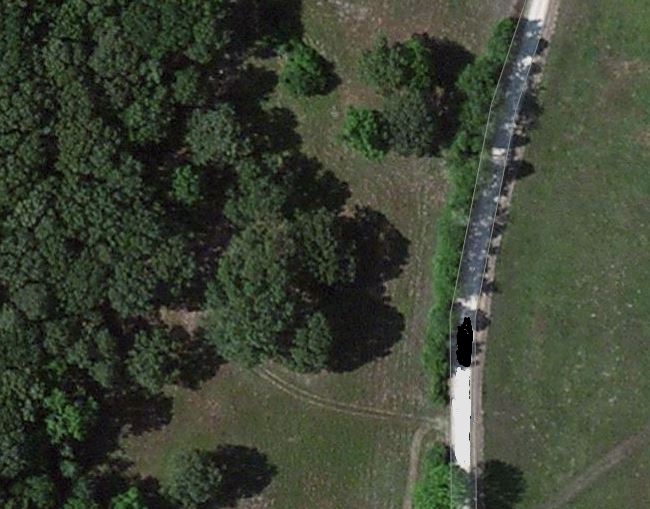

Here is a more representative picture of the trees since we had some timber cut. Also, the section of trees in blue have now been clear cut.
I'll take a look at the options you provided and get one of the antennas and preamps on order.
Does any one have the potential to be significantly better then the other?
If we can pull in several channels we'll be happy.
Does anyone know if our Weboost cellular signal booster will have any negative effect on the tv signal? Is it ok to mount on the same mast?
Also, was there much improvement in going from 20' to 30' height? I'm guessing that will be somewhat dependent on the trees in the direction of the signal.
That looks much better. Where did you find that more recent photo?
I found it on TerraServer.com but if you zoom in too far, it switches to the same image you had.
I just found this one on maps.google.com that is even more current. The gaps are starting to fill in with undergrowth but it isn't over about 10' tall.
