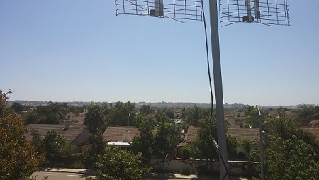

Old 17-Sep-2016, 9:27 PM   #14
760side
Location: Oceanside Ca
Posts: 34
finally
Heres the pictures of my setup, the direction the antenna is pointed and the HDHR signal reading after a sight adjustment...and I mean maybe rotating 1/4 of an inch

Old 17-Sep-2016, 11:10 PM   #15
Thanks for the photos. The HDHR readings indicate that NBC should look good on the TV; does it, or do you still have a problem?

Old 17-Sep-2016, 11:17 PM   #16
760side
Posts: 34
yes its fine for the time being but usually around 5 or 6 at night the reception starts to break up every now and then.

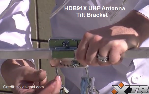

Old 17-Sep-2016, 11:40 PM   #17
What is that in the photo, is it the VHF yagi?
Could be from a temperature inversion that helps the propagation when it is hot, but when it cools down the signal is weaker.
I still think tilting the aim of the antenna up might help. It would be a custom modification for the DB8, but there is a tilt adjustment on the 91XG and the HDB91X that allows you to tilt the front of the antenna up.

Old 18-Sep-2016, 1:38 AM   #18
760side
Posts: 34
The 2nd antenna is a vhf yagi that pulls in channels 8 and 10 solidly. Yes i know it needs to be more level but I have no problems with those channels.
I will look into tilting the antenna up.
