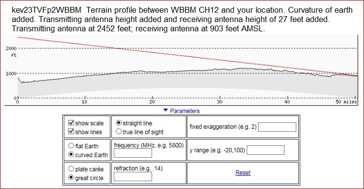

More height would help. Try running your tvfool report at different heights to see where the signals become LOS.
This is what I got at 50 feet:
http://www.tvfool.com/?option=com_wr...e2cbed21f2da27
You can see how the signal grazes the terrain just before it reaches your antenna.

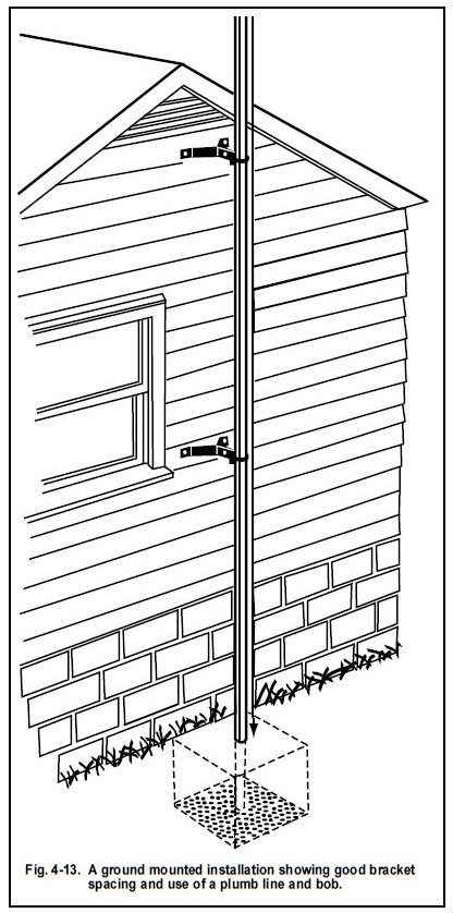

Is there a more stable option other than just a pipe mast?
I wouldn't think a 20' mast would be stable enough.

With that big antenna, anything more than 5 feet above the upper bracket should have guy wires. You can buy a tripod mount for the roof, but it would require roof penetration for the fasteners done by a roofer to reduce the chance of leaks.
Try the easiest height you can do now and see how it does. You can always go higher later if needed.
I'm not sure what type of mount is best for your house because I can't see it from here. Maybe a mast coming up from ground level would be best.
