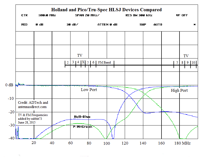

You have some strong FM transmitters in your area. FM interference to TV reception affects the VHF-High channels before UHF channels. I not sure if the FM filter in the 7777 is sufficient.
http://www.fmfool.com/modeling/tmp/b...7/Radar-FM.png

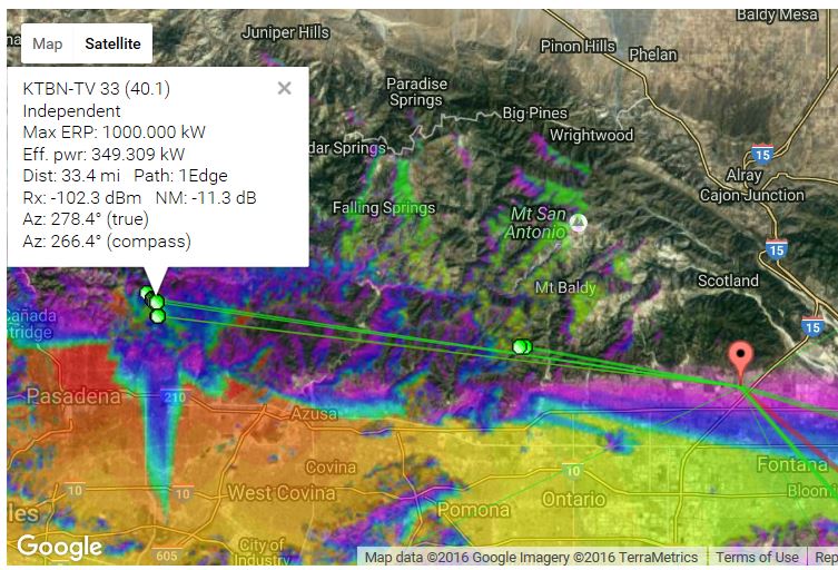

You are on the edge of a dead zone for KTBN coverage; no color, no signal:

There is one experiment that might be worth trying. Insert a HLSJ, common and high ports, between the antenna and the input of the preamp. This will block signals below channel 7, including the FM band.
Even if your antenna is aimed away from KVCR, I still think it might be too much signal for a 7777, assuming your tvfool report is an accurate prediction of the signal strength arriving at your antenna.

No. The CP-2532 is a simple splitter. The HLSJ, is a frequency-selective splitter/joiner where each port admits only a certain range of frequencies while rejecting others. The HLSJ allows for combining different-band antennas without interference and minimal loss and may also serve as either a high or low pass filter when used as prescribed.
Old 8-Sep-2016, 3:46 PM   #19
Ha, Ha; thanks for the link to the Bugs Bunny Broomstick Bunny video.
ADTech is correct. The high port of the HLSJ is a high pass filter that will only allow signals above a certain frequency to pass.
Take a look at the high port curves of these two HLSJs:
