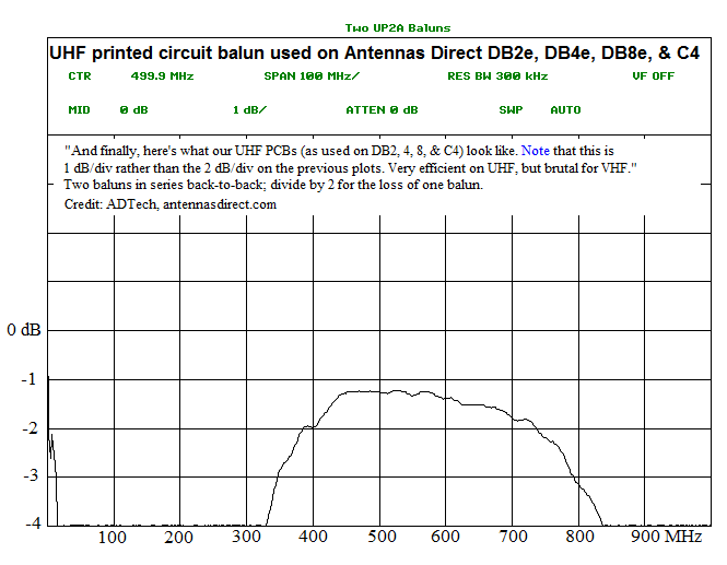

A DB4e is unlikely to get WBBM
I agree, its signal is marginal, and it is VHF.....not what the DB4e was designed to receive. Also the PCB balun is excellent for UHF, but has a high loss for VHF.
