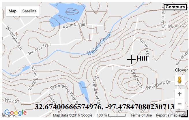

Unfortunately, the new home is at the base of a hill. The hill is about 30 yards to my south and is between me and all the local TV transmitters. I'm located too close to the hill for line of sight to the transmitters. The part of the hill between the transmitters and me is about 12 meters above me.
The TVFool google earth map shows purple (poor reception) at the top of the hill. but from the top of the hill there is clear line of sight to the transmitters. The same map shows good reception at the base of the hill which doesn't have line of sight. That doesn't make sense to me.

The hill is about 30 yards to my south. There is a creek between the back of my home and the hill. The hill and extends east and west for a long distance. The part of the hill in my way is roughly at
32.67400666574976, -97.47847080230713
and its elevation is about 237.623 m or 779.604 feet

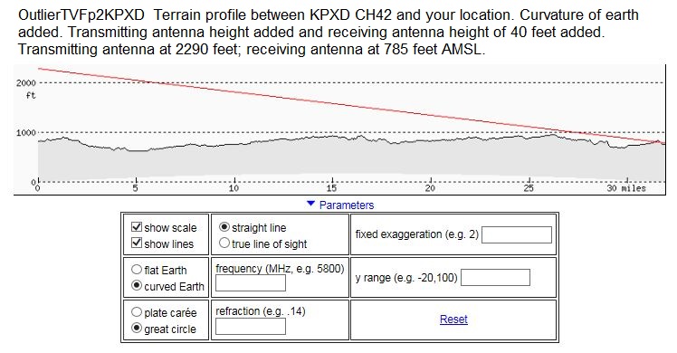

I did three reports using your coordinates at different heights. They indicate that you should get your antenna as high as you can, and you should have reliable reception.

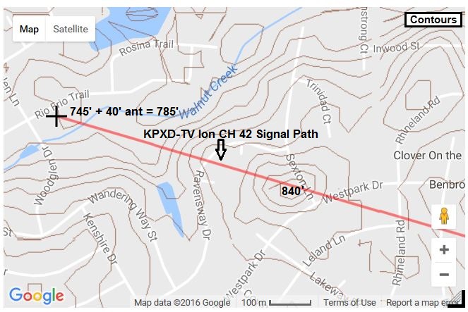

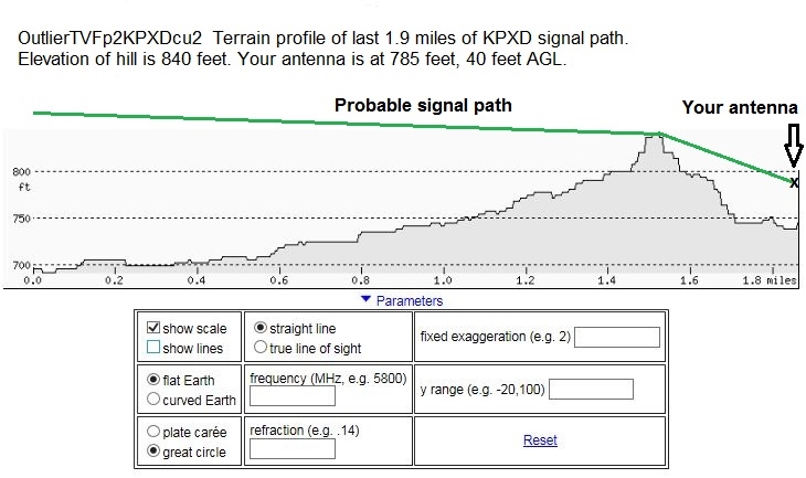

I also did 3 snips from the interactive browser at different heights; see the attachments. Because of the rough terrain and the slightly different locations for the transmitters, the channel listing changes at different heights.
Can the signal make it over the hill?
For some of the channels, my opinion is yes, if you can get your antenna high enough. Tilting the front of the antenna up might help.

That is not the location of your new home according to your first post; I'm confused.
Your original coordinates put you new home in Benbrook TX on Rio Frio Trail. I see the hill and the creek there.
Your new report puts your new home on Hawkins Home Blvd off Hwy 377 near the Whitestone Golf Club. That location doesn't match your description and has these approximate coordinates:
32.651843,-97.501564
This is where you said the hill was:
Where is your new home? It makes a difference in your report because of the hill.
My answer remains the same: you have a good chance of receiving some channels if you can get your antenna high enough.
You will need a combo antenna aimed at 102 degrees magnetic for VHF-High and UHF because ABC is on real channel 8. I doubt that you need a VHF-Low antenna for channel 6 because KBFW is an FM station disguised as a TV station. You can listen to it on 87.7 FM. KSFW is infomercials.
If you can get it high enough a Winegard HD7694P might work; the bigger HD7698P has more gain. Tilting them would be a DIY modification. Try it without a preamp first. If you have more than one TV you might need a distribution amplifier. A last resort would be a preamp instead of the distribution amp.
