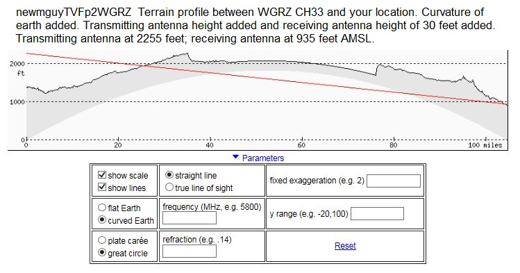

Welcome to the forum, newmguy:
Thanks for the tvfool report and the detailed description of your setup. I think you are doing better than expected with WGRZ which is a weak 2Edge signal 104.5 miles away. The main problem is the curvature of the earth. The only way the signal can get to you is by refraction which bends the signal around the curvature of the earth, but atmospheric conditions will affect the refraction.

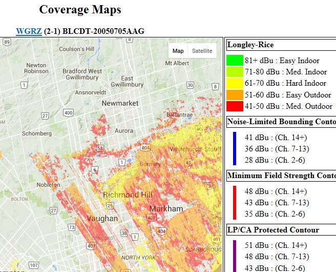

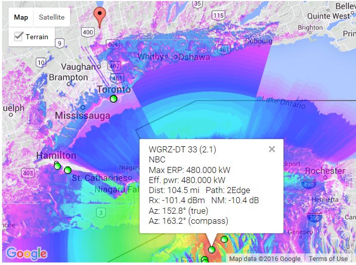

Using a coverage map from the tvfool interactive map browser, you can see you are beyond the fringe:
and here is the Longley-Rice coverage map. Red is a weak signal and no color at East Gwillimbury is even weaker:
This is the link for the Longley-Rice WGRZ map:
http://www.rabbitears.info/contour.p...=1070336&map=Y

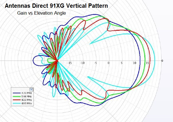

Since the signal quality is quite good (most times) I was wondering if there is
a solution for picking up WGRZ reliably.
I doubt that WGRZ will ever be 100% reliable, but you might be able to improve the reception if you are willing to spend more time and money on the project.
I know there is a trial and error curve, but I am at a loss as to what to try next.
There are a few things you can try; no guarantee.
Maybe there is another antenna that would be better for me?
With a NM of -10.7 dB for WGRZ, a little more antenna gain might help.
The C4 gain is about 12.0 dBi at 587 MHz.
https://www.antennasdirect.com/cmss_...-sellsheet.pdf
The DB8e is about 16.0 dBi with both panels aimed in the same direction
https://www.antennasdirect.com/cmss_files/attachmentlibrary/Technical%20Data%20PDF's/DB8E-TDS.pdf
The 91XG is about 14.5 dBi
https://www.antennasdirect.com/cmss_files/attachmentlibrary/Technical%20Data%20PDF's/91XG-TDS.pdf
and the 91XG has a tilt adjustment that would allow you to tilt the front end of the antenna up to better catch the incoming signal

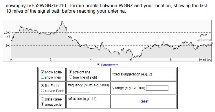

Old 26-Jun-2016, 6:37 PM   #5
When I first put up the antenna WGRZ signal was stable almost every day. (That was in cooler weather, back in April)
That makes perfect sense. In warm weather, a temperature inversion is formed in the signal path. This causes the signal to be trapped in a high altitude duct, unable to bend down to your antenna.
http://www.mike-willis.com/Tutorial/PF6.htm
scroll half way down to Example of a path profile diagram that shows how refraction bends the signal to your antenna
http://www.dxfm.com/content/propagation.htm
scroll down to An illustration of a high-altitude tropospheric duct.
It is most likely to happen when the signal starts at a high elevation and there is a bowl between the two antennas where the inversion forms, just like what you have.

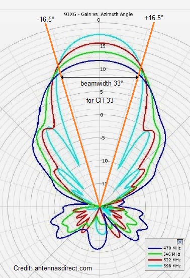

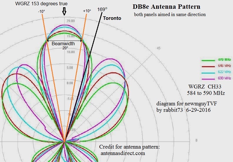

I am having difficulty determining the beam width of each antenna. Are they 30 degrees? Are they both the same?
The beamwidths are stated in the technical documents mentioned by ADTech in post #10. I gave the links to the technical documents in post #4 and now again here. The beamwidth is frequency dependent, and is defined as the angle between the half-power points (3dB down) each side of the max.
DB8e:
The beamwidth for the DB8e is about 20 degrees.
91XG:
The beamwidth for the 91XG is about 33 degrees.
You would think that the beamwidths would be about the same because the gains are similar. They are not the same, because the patterns are different. The 91XG has one major lobe, but the DB8e has a major lobe and two minor lobes because it is equivalent to two DB4e antennas side-by-side. The C4 is similar, like two C2s side-by-side.
Why are you concerned about the beamwidth?

Thanks for the report with the news of your progress. It does sound like the DVR has a good tuner. How does the Sylvania SPAT102 ATSC Set Top Box do with NBC?
Here is the pattern for the DB8e:
and for the 91XG:

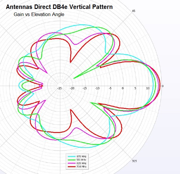

Old 30-Jun-2016, 10:07 PM   #20

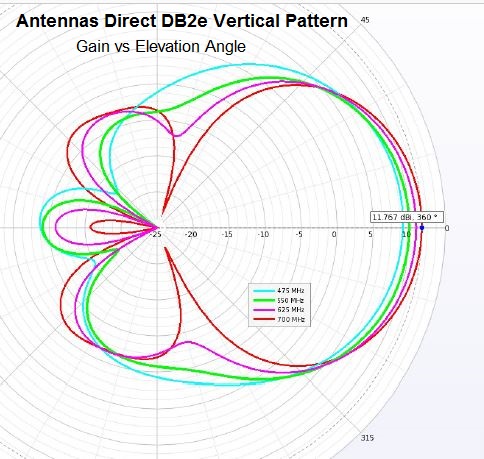

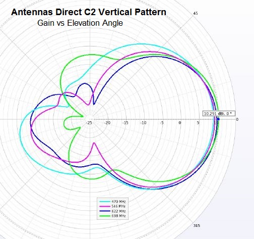

Sorry to hear you are having trouble. The DB8e should be doing at least as well as the C4 based on gain figures.
on the roof with nothing connected to the antenna except the receiver.
No preamp?
Maybe ADTech will stop by and help.
I wonder if the antenna needs to be aimed a little up from horizontal by tilting the top back? The 91XG has that tilt provision, but not the DB8e. There are documented cases where the tilt feature of the 91XG made it possible to receive signals that were otherwise impossible. It is possible that the incoming signal is arriving at an angle above horizontal because of the curvature of the earth and the hill that is about 7.5 miles out. I have noticed that I sometimes need to tilt my 4-bay antenna back to aim above horizontal for a max reading on my signal level meter.
The C4 has a vertical pattern similar to the C2; there is no notch where the gain is reduced:
And the DB2e has a similar pattern:
BUT the DB4e and DB8e have a deep notch (null) in the pattern:
and the 91XG also has a notch, which makes its tilt feature useful:
In the last case I worked on the optimum angle was 15 degrees.
