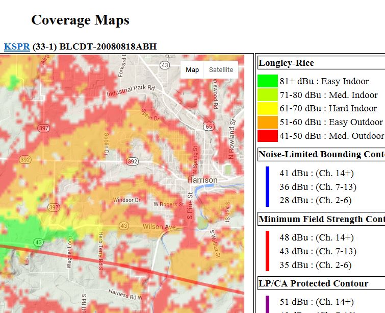

You can see that you are on the fringe of coverage for KSPR ABC:
Here is another coverage map. Red color is weak signal. No red, weaker signal, like Windsor Dr:
