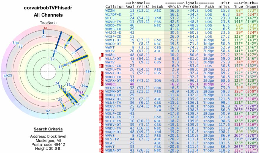

OK, I think I have the address figured out. TVFOOL has trouble with 1393 s quarterline rd, it only knows 1393 quarterline rd because it uses Google Maps, but the white pages and Bing Maps do know 1393 s quarterline rd.
And it didn't help that I used MA instead of MI for your report in post #9; I corrected it. Sorry about that.
As a double check I did another report using the tvfool interactive map browser here:
and saw that the marker was in front of Port City giving this report:
http://www.tvfool.com/?option=com_wr...5134525ed757c7
I also saw a lot of trees; they will block TV signals.
I have the same trouble with the colors in the report if my laptop screen is at the wrong angle; they are too light.
You should be able to get the green ones with antenna #1 and down into the pink with antenna #3 if its preamp isn't overloaded by strong signals.

thanks. the first link did not show anything but the second one did. so far i get 13, 17, 29, 49 and 54 sometimes with pixelation. no 35, 42,46,15,19,0r 7 which seems to be in these antennas range. and line of sight. antenna 2 gets me 49 13 and 17 it was built by tv 49 he told me i should be able to get 9 to 22 channels and i get qt least 9 which are 13 and 17 and not his station. next week i'm going to raise the system up to at least 30 ft above the ground now it is 10 and i did have it to 20 earlier. i have antenna 1 pointing ne and antenna 3 pointing se with antenna 2 on a different pole. i don't have any amp on them now but for antenna 3's internal amp. and they are on a combiner the is both a combiner and separator. i do have a preamp that i had them connected to before and what video i got was clear. i guess a bit more testing to see what channels work the best with each antenna is in order. again thanks for the help. not sure what your calling pink unless it is what the site calls red. unless it is wwmt tv and wotv which are 52 and 58 miles away, they may be hard to get. but i can't get the yellow ones yet either and half of the green ones. thanks bp.
corvairbob is offline   Reply With Quote
Old 25-Apr-2016, 1:27 AM   #13
The first link is where you can enter your address to use the satellite map to see your location.
Red is the correct name for the color; it just looks pink on my computer.
http://www.tvfool.com/index.php?opti...ask=view&id=57
Good idea.

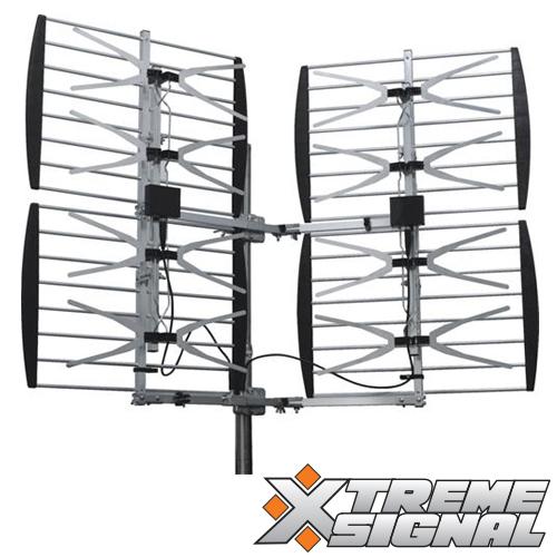

thanks rabbit73. tell me what do you guys think of this antenna setup? i can point it 2 directions at once and they claim 60 miles but if i can get 30 i would see plenty of channels. at least 10 with their multiples that most have. like 13 has 3 17 has 3 etc. and maybe i can get 2 and point 1 set to the SE and 1 set to the NE. any thought on those unit? thanks

Sometimes it works, but usually not, in spite of what the marketing department says. You just have to try it.
It works OK when both panels are aimed in the same direction, but when they are aimed in different directions, the signals from each antenna can arrive at the combining point out of phase causing a loss of signal.

i got the quad antenna and found so far i have to point them in separate directions. i have the yagi pointing to the SE and the dipole on the SW of the mast just above the roof for channel 49.X seems when i pointed the thin with both sections to the SE i lost channels and the same the the NE. but when i put one NE and one SE i gained 2 channels for a total now of 16 channels. i may get one more and point one SE and one NE and take down the other units and see if these do any good. if not i can sell one i'm sure as it did do the job. it may be like rabbit73 says the beams are canceling out some of the signal to this bay unit. i will keep you posted when i make more progress as i experiment. thanks so far for the help bp.
