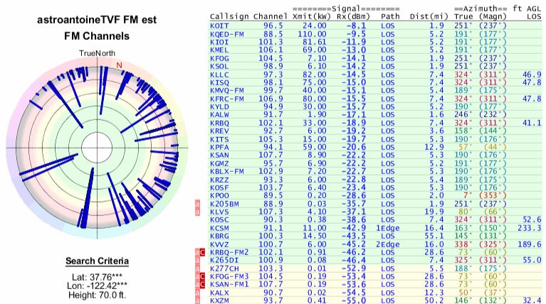

Multipath reflections are certainly possible, but it looks more like overload not only from TV signals, but also FM signals that are too strong.
