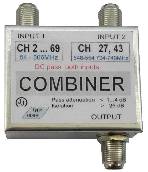

There is a new company based in Slovakia, jan_jenca, that has been an eBay member since Jan 30, 2013. They make custom antenna combiners for a reasonable price. This is an example of a UHF combiner that they make; they can also make one for VHF:
http://www.ebay.com/itm/Selective-combiner-for-2-antennas-Selective-channel-combiner-UHF-combiner-/121884348649?hash=item1c60df90e9:gGAAAOSw~bFWNinN
AVS thread on the topic:
http://www.avsforum.com/forum/25-hdt...xchange-4.html
http://www.avsforum.com/forum/25-hdt...xchange-5.html
